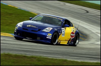

We run a Dunlop slick, 250-640-18 up front on a CCW 18x9.5" wheel, and Dunlop slick 285-680-18 rear, on 18x11 wheels. We sell these slightly used slicks for $85.00 each, and sell the CCW wheels as well.
Attached Thumbnails What are people running for wheels and tires on the track (road racing)-nt350.jpg
