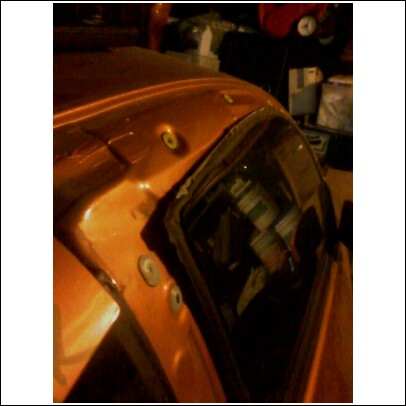

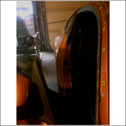

Installer is coming to change my windshield tomorrow, I guess I'll go ahead and try to remove the A pillars, I'm following the directions used above........
Old Nov 16, 2008 | 11:23 AM
TRYNALIVEPRO's Avatar
TRYNALIVEPRO
Posts: 2,306
From: ZOO YORK
I suck, I think I broke it. I did everything up to the part trying to pull the big rubber molding off and there's like a glue-like substance underneath the moulding, so I left it alone, and decided to pull on the pillar, I heard cracking... snapping. The hell with it i kept pulling and cracking and snapping and cracking.

I hope you are using more than just double sided tape to hold them down. I believe you are supposed to actually screw down the lip that goes under the rubber window molding for added security.
Look fellas, I don't know if you guys realize this, but all it takes is a simple run of maybe 80-100mph and/or a strong gust of wind while on the highway and POOF, the A-Pillars are History. The edge of the A-pillar that sits on the front windshield must be secured and flush to the glass or else it will to rip the entire A-Pillar off the car.
IT MUST BE FLUSH ON THE GLASS.
If it is any bit loose, it is not secure enough for high speed and will break and fly off the car. The OEM pieces are very delicate pieces of ABS plastic and the weakest link on them is these small plastic tabs that plug into the many small holes along the edge of the pillar along the window line. If they break you will have to improvise some way to keep the edge down. Double sided tape may work for a small area, but the most important edge is along the front windshield (IMHO).
Each of these OEM pieces are in the low $400 dollar range (EACH). If you cannot afford replacements don't mess with it. Even the Carbon Fiber replacements are not perfect.
I removed my OEM pieces to have them wrapped in CF by someone on the forum. I was very LUCKY I guess to only have broken the underside part of the A-Pillar (the lip that goes under the rubber molding.) and none of the tabs broke. My mistake was selling the CF wrapped A-Pillars to someone with broken A-Pillars that never sat right. And you guessed it, one day while on the highway the passenger side broke and flew up in the air about 30 feet before landing on the highway only to be run over by the next car.
Lesson learned. Don't become a statistic.
If you guys have any concerns about performing this task, please take a safe route and let a body shop do it, so that it is virtually guaranteed in case they break your stockers that they will be replaced. If you break it and want to go back to stock that $400 + per side.

Sorry to have to be the ahole but If you follow these instructions you ARE BREAKING YOUR A-PILLAR. No disrespect to the OP but I would hate to see anymore Z owners breaking such an expensive piece.
Besides the 1 visible screw and tab that attaches the A-pillar to the car there are 8 other hidden screws and tabs that are only accessible by removing the rubber body stripping. Underneath the rubber body stripping you'll see a small retainer strip attached by 8 screws. These 8 screws are also attached to the A-pillar via the hidden tabs.
All that snapping and cracking you are hearing while removing the A-pillar via this method is the 8 hidden tabs breaking off the A-pillar!!! If you are going to remove the A-pillar, remove the rubber body stripping first and unscrew everything. The rubber stripping is attached with 6 clips and doublesided tape on top portion of the stripping and can be removed with care. You can reattach the rubber body stripping with double sided tape.
I found this info on the 2004 service manual which can be found and downloaded in these forums. The section where they cover this is under "Roof Side Moulding" in the Body Chapter.
Once again, no disrespect to the OP but at 400 dollars a pop to replace, this shiet can get really expensive! Hats off to you for posting though. Spread knowledge!

Updated once more 8-11-09 with pic revealing screw locations prior to removing A-Pillar. Hope this helps. Thanks to those who helped to bring this to my attention. Hopefully this will eliminate any more horror stories.
