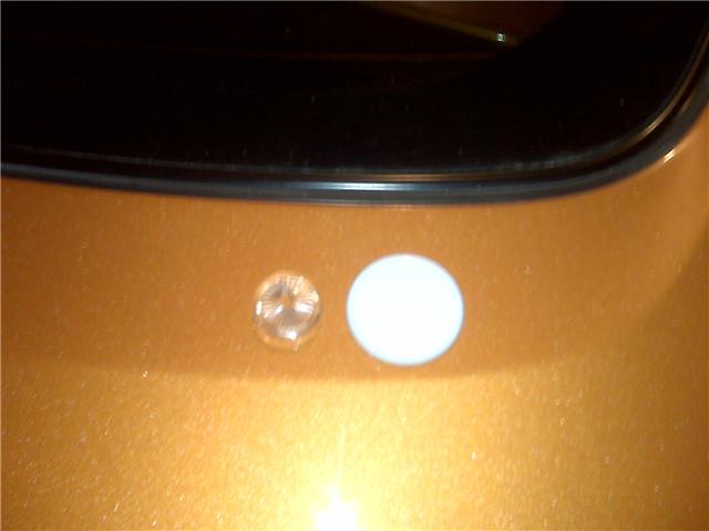

I'm sure everyone has seen at least 3 treads on how to remove and cap off your rear wiper, the only reason i post this is because i found a better fitting piece to replace the hole where the rear wiper motor comes through. I may not be as detailed in my step by step processes since i'm sure everyone has seen how to go through the steps. If anyone would like any details, just post.
The piece that i used are the little plastic pieces that are on top of some older faucet ***** to cover the bolts, they typically have a H (for hot) or C (for cold) on top, these are about 3/4" in diameter. The piece that the other threads have; the faucet stopper, is way too big and looks a little hacked (altho it does create a good seal). See how the sizes compare in the picture below, new piece on the left, and faucet stopper on the right.
Anyway, these pieces fit right in the slot, i just used crazy glue to get them to stick and hold a seal, car was parked out side all night and it rained last night, no leaks.

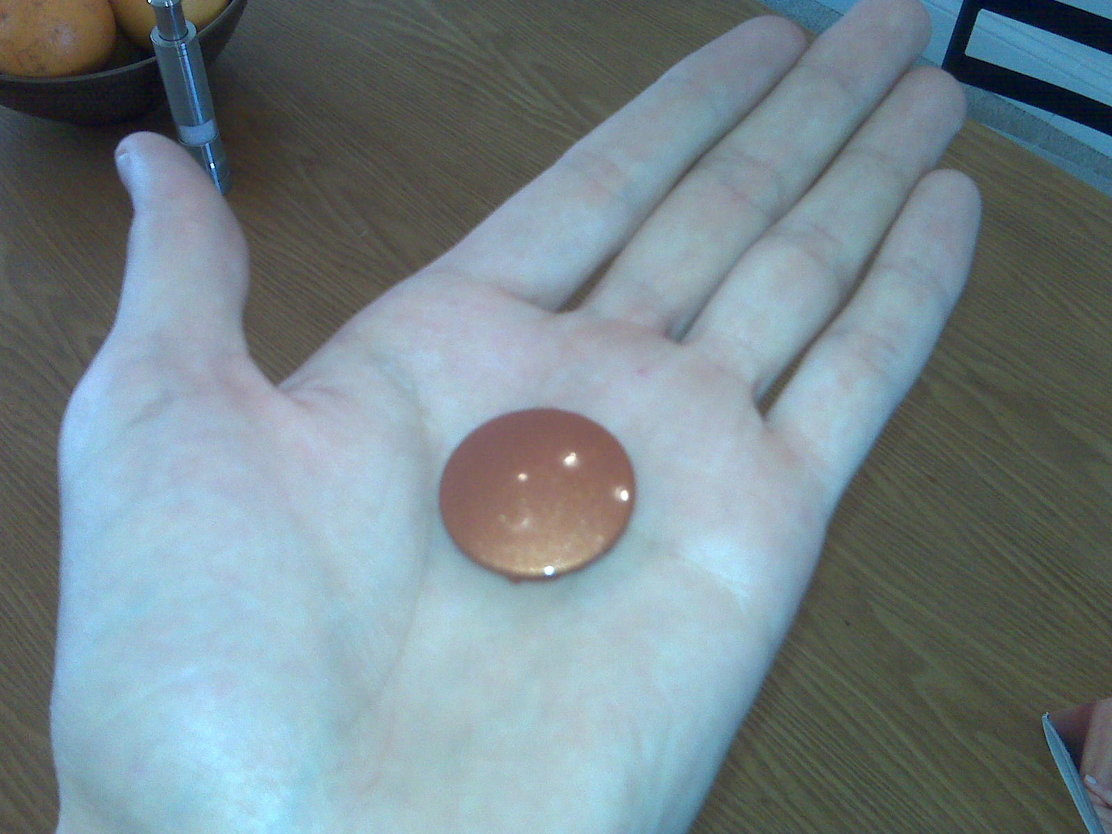

Pics before/during/after below...
These can be found @ home depot for $1.50 for a 3 pack.

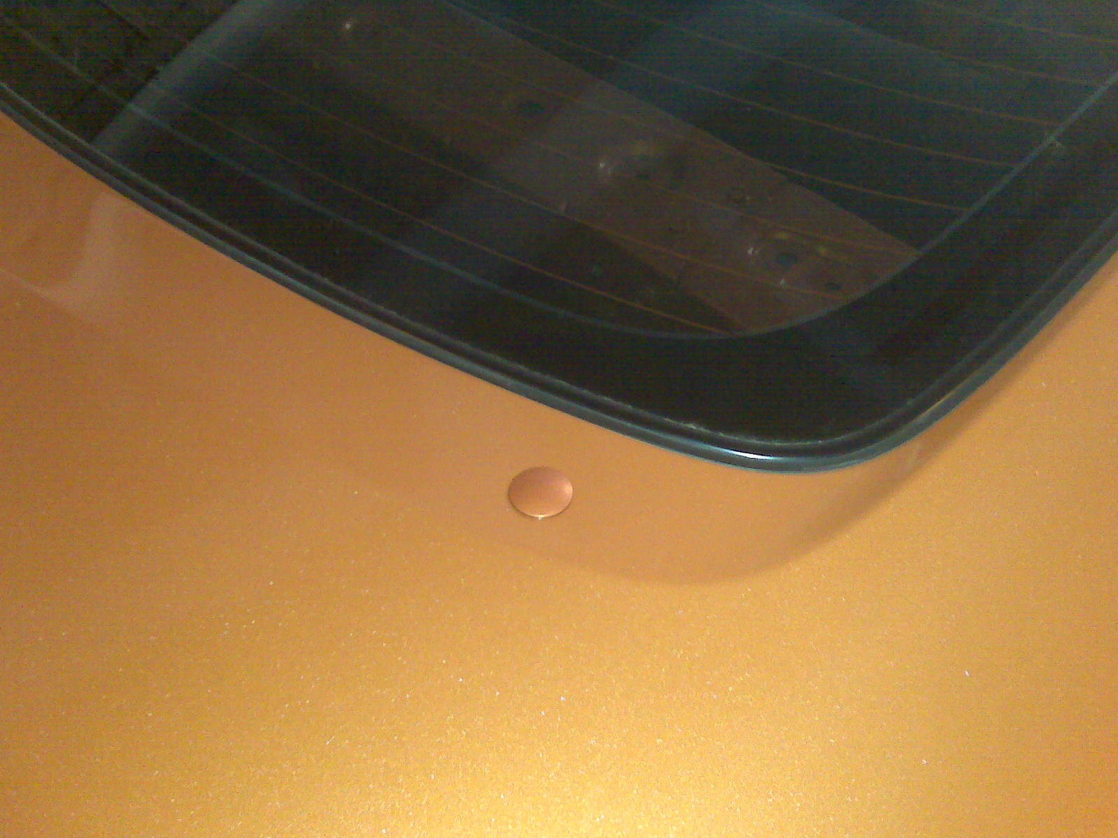

The color match is almost perfect, if i would have used a white base coat, it would have been exactly right, but hey, its close enough.
