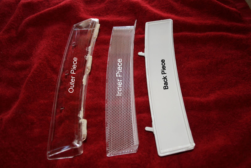

As I suspected, the '06-'08 side markers are actually 3 pieces.

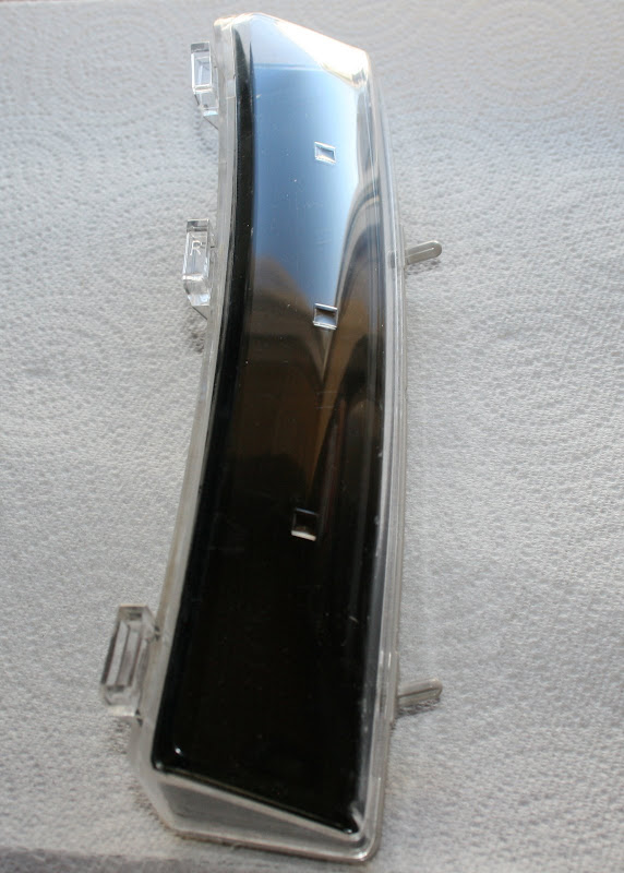

Fig 1: Side marker is actually made of three pieces. Named each piece for future reference.

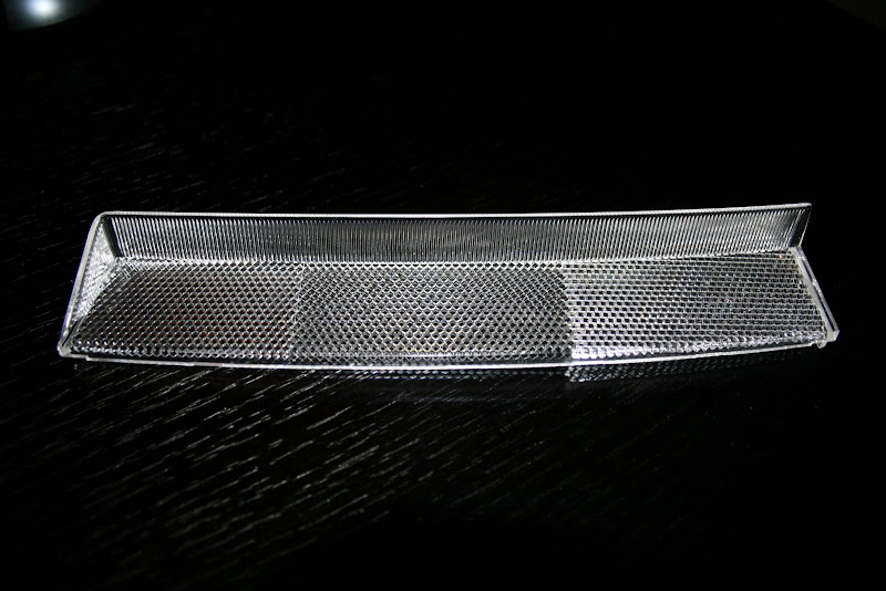

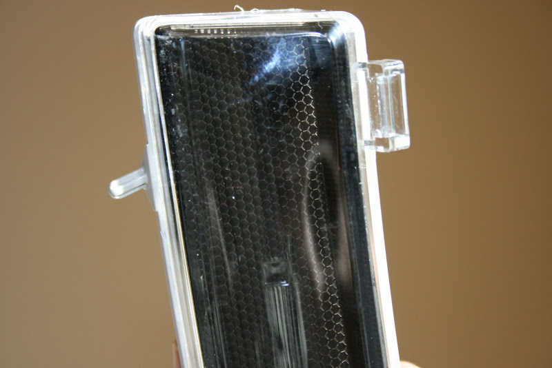

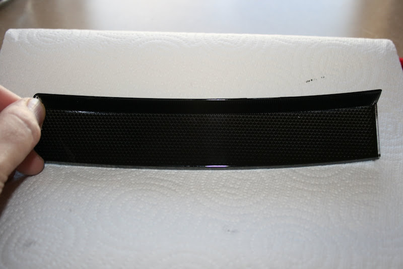

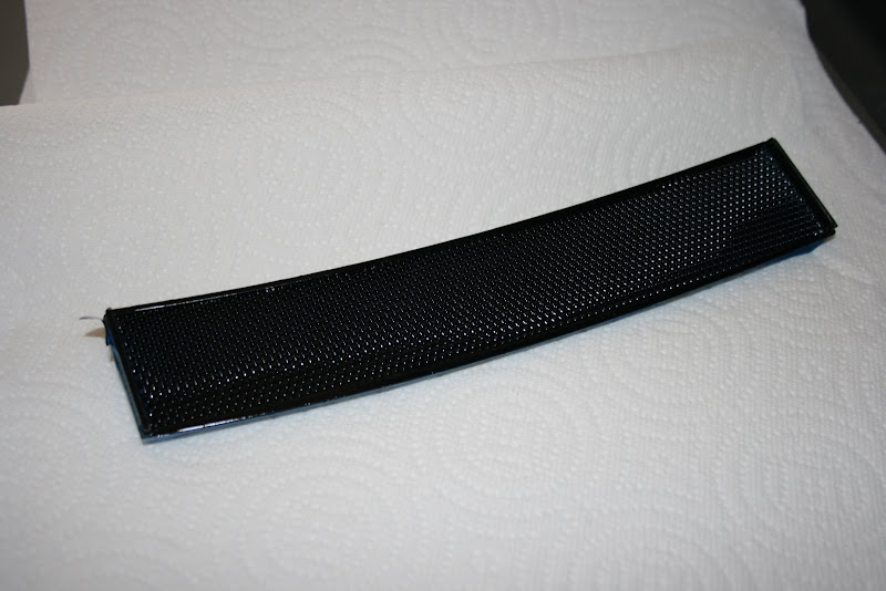

Step 4 - Since I chose option A, I taped off the front sides of my inner piece. The back side of the inner piece is textured on the large surface, and smooth on the small. Rattle-canned the back with two light coats.
Fig 2: Back of inner piece painted. Two light coats.
Fig 3: Inner piece, as viewed from the front, after painting. Note that the "reflective" surfaces are still visible here.

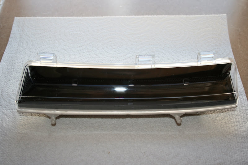

Step 5 - Reassemble and reseal. I just used super glue, but I probably should have used a silicone of some sort.
Fig 4: Sealed up and ready to go.
Fig 5: Another shot once sealed.

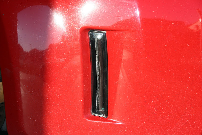

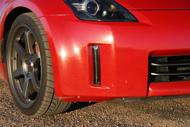

Fig 6: Close-up in the sun.
Fig 7: Close up once installed. Note that the side still reflects the sun due to the texture of that part of the inner piece.
Fig 8: Looks just fine from the front too.

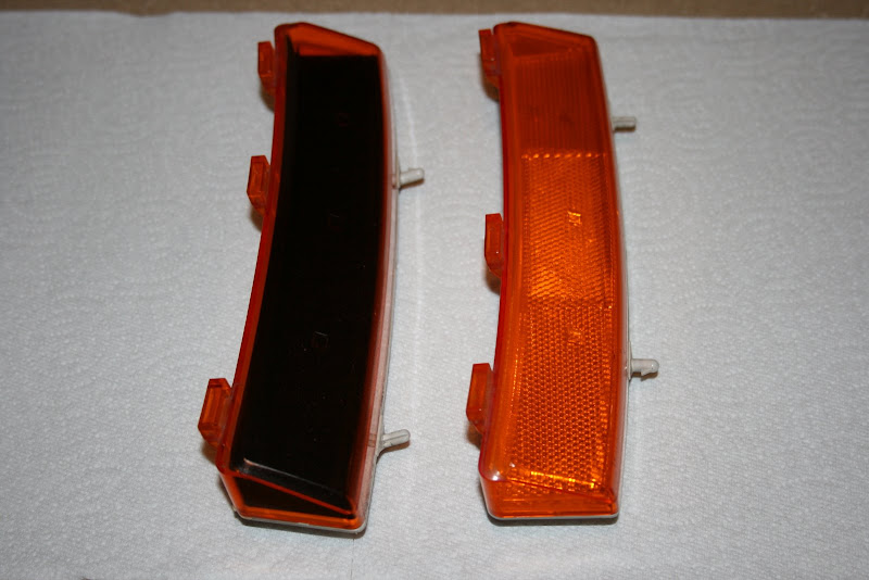

If I get ambitious tonight, I might bake open the ambers to see what that looks like. One thing for sure, the inner piece on the ambers has much better reflective qualities... It probably boils down to some US regulation somewhere. Anyway, I would be curious to know if the inner piece on the USDM amber side markers is amber or clear. My guess is amber, but who knows.
Even if it is amber, what would it look like once painted? Maybe the USDM's can attain similar results without having to invest in clears to begin with.

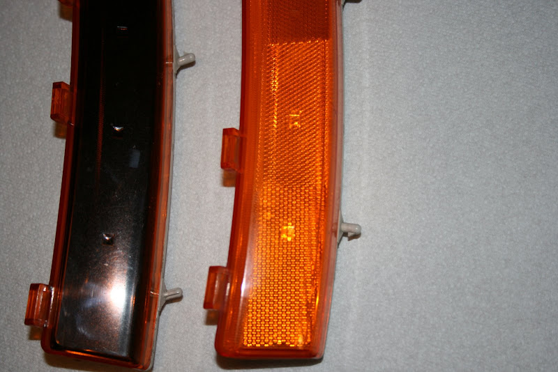

The inside of the USDM Ambers ARE clear! But, they may have a "silvery" coating to enhance reflective properties... and they were significantly tougher to crack open, and the one I did get open resulted in a "ring" of amber plastic left on the back piece. I am going to experiment a little and see what I can come up with.
If anyone wants to donate their ambers to the cause, I would be happy to try variations... it would be a true donation, as in don't expect them back in perfect shape. But if anything good comes of it, you can have them back if you want them. PM and we can work something out.

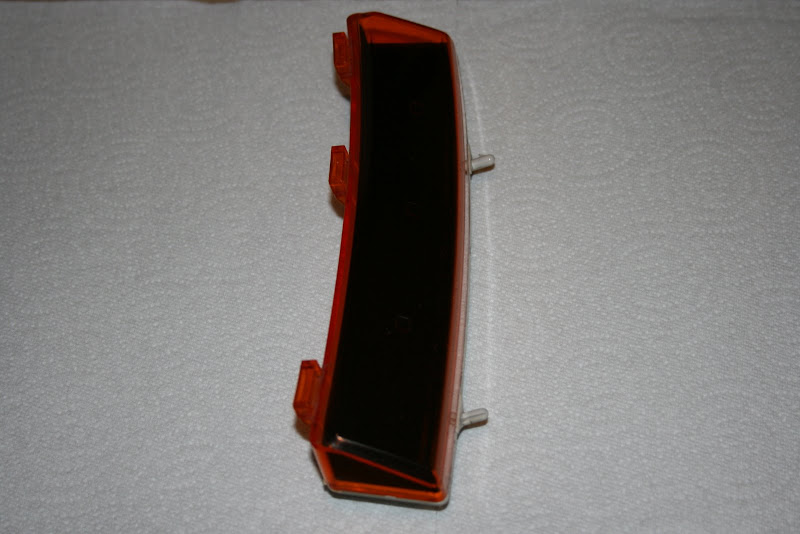

Yeah, there would be a lot of room for LEDs in there... even between the back piece and the inner piece, there is roughly 4.5mm of space there (little less than a quarter of an inch).

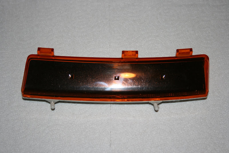

Here is inner piece painted black (just like I did in the clears) with the amber cover.
I have concluded that you would retain little or no reflective properties, so one may just want to spray the inside of the amber cover black and get almost the same effect.

Wish I have seen this before blacking my reflectors. I did 4 coats total, 2 in the front and 2 in the back. Wish I did 2 coats in the back.
As for sealing the reflectors, use Nissan Butyl Sealer. It is the best sealer there is.
