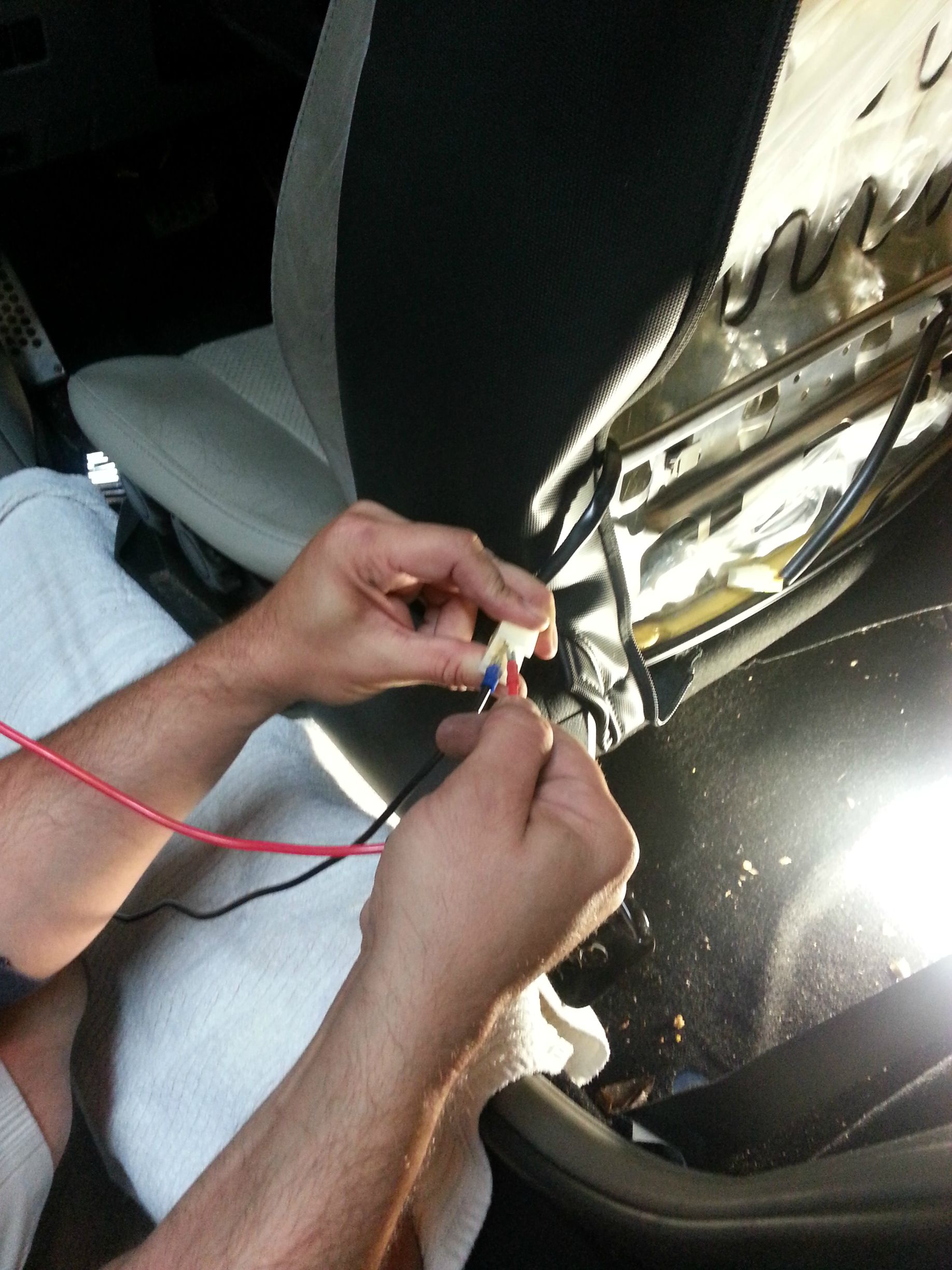

Affirmative! I was able to do this a couple nights ago, and took pictures with your post in mind
First of all, thanks to OP so much for the original DIY, and for the great replies. This thread makes me happy.
So, as mentioned, the wire harness that controls the forward-backward seat motor is located below the seat in the front. BUT, for the seat recline wire harness, you have to find it in back of the seat; it is connected with a plastic clip to the metal bars that strengthen the lumbar portion of the seat back rest, and furthermore the wire harness is accessed by unzipping the leather seat back flap. (this is all occurring in my 2004 Touring model)
I was able to zap the seat recline wire harness the same way members on here zapped the seat forward backward wire harness. Total success! Pics:
Back of seat, in the seat back-rest area, after un-zipping the back seat flap/cover:
Connecting wires into the seat wire harness, the other end of my wires are connected to my car battery, and I crimped-on clips to the end I'm using to connect to wire harness, for ease of use:
