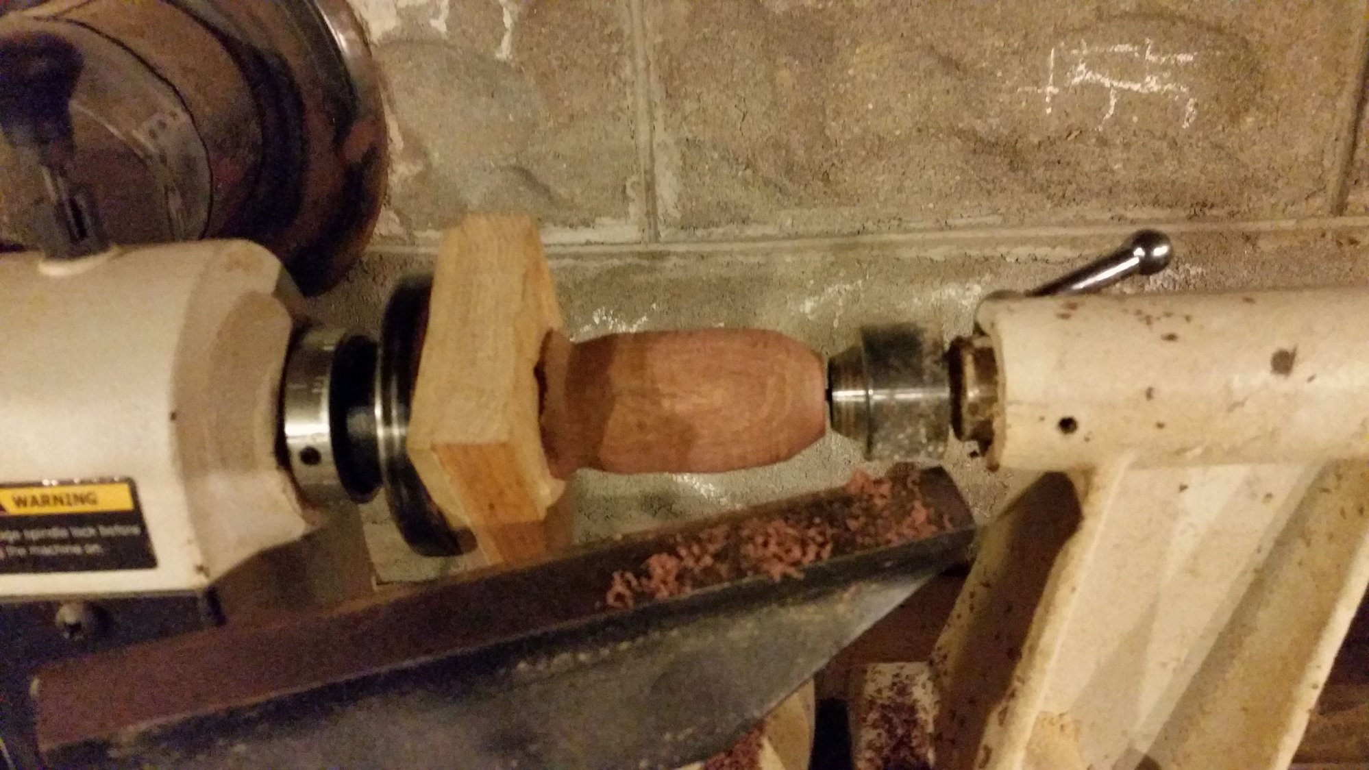

So now that we have our nuts installed what are we going to do with this mess...
Gotta set up the mini for **** detail, if you have one you probably can figure it out... But this is how mine looks for starting the project.
I got a few different bolts for the different offsets of the nuts, had to use a piece of 1/4 inch plywood with a large hole drilled in it. (For the bolt head to fit into) then a piece of hardwood with a hole the exact size of the bolt. The hole needs to be damn near perfectly centered in the backer plate.
I managed to get a centered hole by using the drill bit mounted on a screwdriver handle and just turned on the lathe mark the center with a pencil then hold the bit to the wood drilling the hole.. (probably confusing if you have never used a lathe)
Spin your project make it look the way you want.. Sand stain poly whatever make it look as good as you can... Be impressed with yourself for making something..

Ok so the gorilla glue on the acrylic didnt work out so great. Broke off rather quickly on the lathe.
The wood is working but also came out after a bit.. Guess I need to use the other side support until its at least rounded... Still working but here is whats going down.
Hopefully the cherry one will work out.

Ok first try has finished in no great success. The nuts are not appreciating the shock of a chisel turning a square into a cylinder... Going to regroup next week and try a new glue..
And hopefully that will actually hold...
My belt sander burnt the **** out of the tip but here is what I managed to get out of my first attempt.
Go easy on me I haven't touched the lathe in 6+ years... Ill give it another shot next week with the epoxy.
