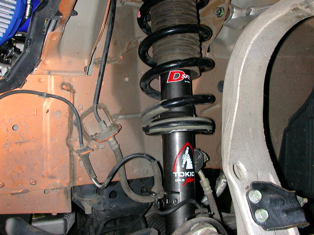

Here is a little picture of the shock installed ... guess I got to adjust the medication before I post hahaha (struts vs. sways)

The NISMO sway / D-specs / Stock Springs works for me. So far, no change in noise from stock (no wierd squeaking or anything else) and handling is much improved. This is where I wish the car had been when I bought it, as far as cornering goes. I was disapointed with stock handling (thought it could be better) and with this combo it is better. Haven't adjusted the D-specs yet, will experiment in the near future.
