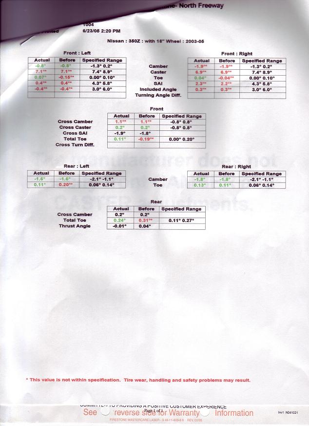

I just had it redone at firestone. They didn't cause the red numbers my car was already like that.
Attached Thumbnails What do you think of my alignment specs?-350z-alignment-specs.jpg

What suspension are you running?? I have an 05 with Tanabe NF and SPC camber and Toe kit in the back and everything is in spec except for camber in the front. My front camber is at 1.7.
I would take it back to them, you should atleast be in the green in the front (except camber if lowered). Am I missing something??
