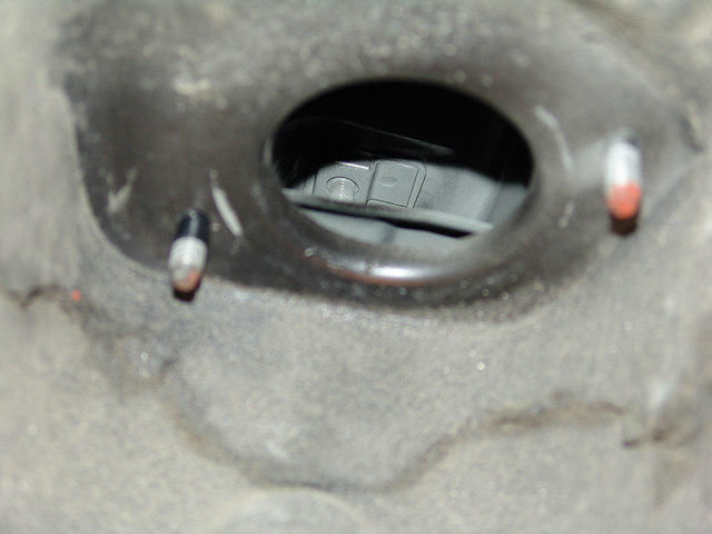

How do you put electrical tape around the studs to eliminate the noise? you mean put tape around the studs first and then thread the nuts/bolts on?

Put the tape at the highest point, to about half way down the stud. You'll have to cut it in half length wise. Make it just thick enough to take out the play. Maybe a 1" to 2" piece. I'll look for a picture.

thx so much. A picture will be excellent!!

Here you go. Sorry it's blury, auto focus targeted depth of field. I forget to tell you to stretch the tape as you wrap it around so it stays nice and tight.
Attached Thumbnails JIC Coilover setup? What's your ride-height?-dsc02284.jpg
