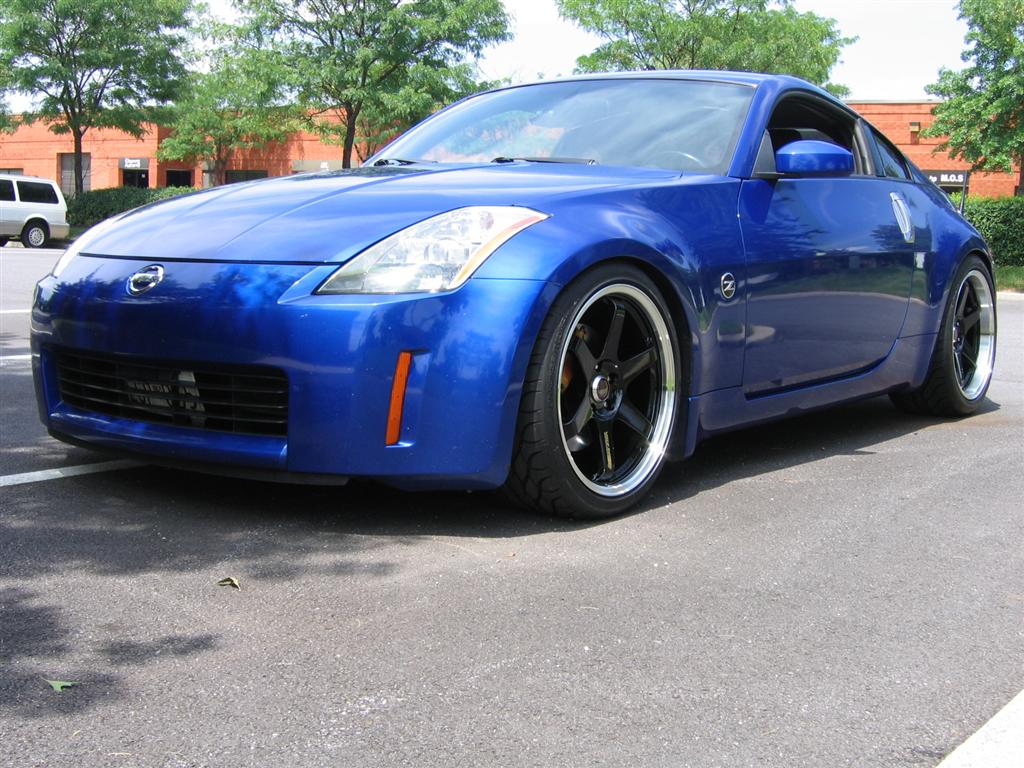

25.75 front
26.50 rear
On 19's now, which in the rear is .2 larger in diameter iirc. I run mine on 3 front 5 rear on the street. When I put mine on 15 they feel floaty, ever since I did my crank pulley my handling changed a little. So I never run the fronts higher than 5 or they dont feel right.

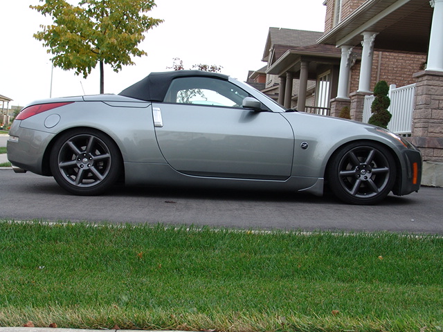

Set mine to 9 front and 8 rear. I find this works best on the street. I'll check the height and post pix tomorrow. With the roadster, you would have to drill a hole through the wheel well that would terminate under the tonneau. I was'nt cool with that, so I take out the rear strut to adjust it. Put electrical tape on the rear upper mounting studs to eliminate the play ( hole in JIC pillow mount is too big and will cause strut to move around, banging on the stud). I also used gasket maker to make custom gaskets for the pillow mounts. My JIC's make no noise at all. I'll most likely sell these and get the HKS Hypermax 2's. They have the rear adjuster on the bottom of the strut. I got the JIC's for less, but if I had known about the drilling, I would have bought the HKS.

Sorry, pix too big to post. About a 2" drop anyway. Maybe more, neighbor has my tape measure.

Are those the LE37T's? 9.5F 10.5R 22 offset? Is so did you roll your fenders? Any rubbing up front with the lowered ride height?
Respect

Here's a pic.
