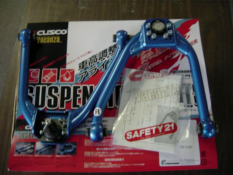

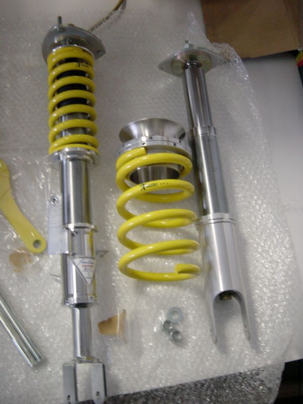

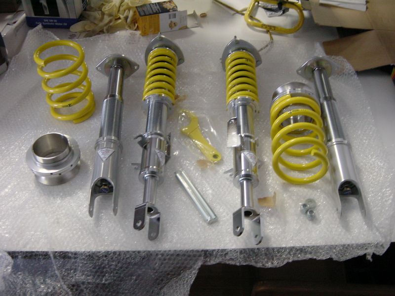

I came to work today and i found these from the ups guy
Anyways.
The are cusco front camber arms and Zeal coilovers.
The quality is amazing. The cusco arms although they won't be seen have a nice sparkly blue to them.

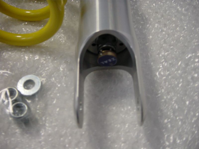

and its nice that i can get more negative camber in the front with them. I will try and get it installed later today. The zeals are nice too. Rears are inverted.
More pics to come don't worry =)

are those the "street" or "hard" springs?
my zeal springs are black, weird

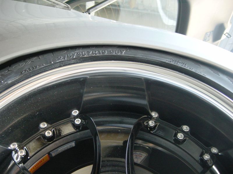

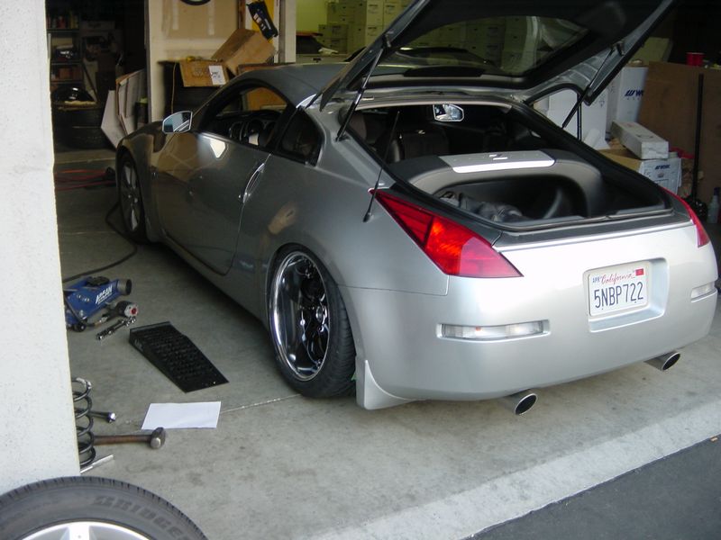

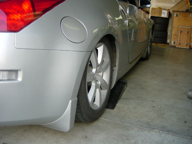

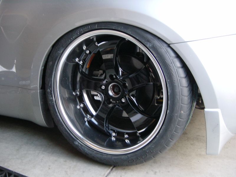

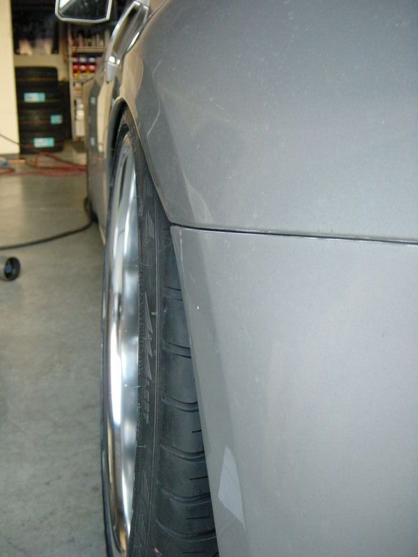

Ok guys..
we lowered the car to the limits on the Zeal coilovers.
It went LOW. We test fitted the wheels on the car and they were PERFECT!!!
i am soo happy. Sadly however i did raise it up 1/2 inch to clear speed bumps. Anyways hope you guys enjoy the teaser pics. Also wanted to show you what the other side with stock tires.
Also i wanted to comment about ride
The ride on the zeals are amazing
i totally forgot what they felt like but boy am i glad i got them. Especially on highway with the joints in the road, i no longer see saw and it is very controllable. The turn in response is phenomenal i can easily take turns when before if i gave it a hard engagement it would understeer a little
now it is riding on rails. The rear of the coils are inverted which allows shock adjustment on the bottom. The megan racing, teins and other ones are on the top. Not the best setup every cause you can't really get to them. Ok so they are on and i love them now i am going to play w/ the dampening it was at 1/1 all of last night.

wow now that is a drop! how do you drive so low???

Where did you buy that mini ramp that I seen in the last picture? That looks like a great solution to get to the front center jacking point.
Old Dec 9, 2005 | 06:48 PM
anotheraznguy's Avatar
anotheraznguy
Posts: 1,963
From: Tracy Ca
i have a spare set of them they are takata's
i used them sooo much
only way to get the car jacked up when i am slammed
Believe me i can't drive over speed bumps basically the car just looks pretty and handles like a monster.
here are some pics of the whole car with the new suspension and new wheels.
Also got an alignment.
with the cusco front camber mount got my camber up to 3.7 degrees negative and my rear are at 4.3 degrees negative. The toe front and rear surprisingly especially in the rear were able to go back to zero.
