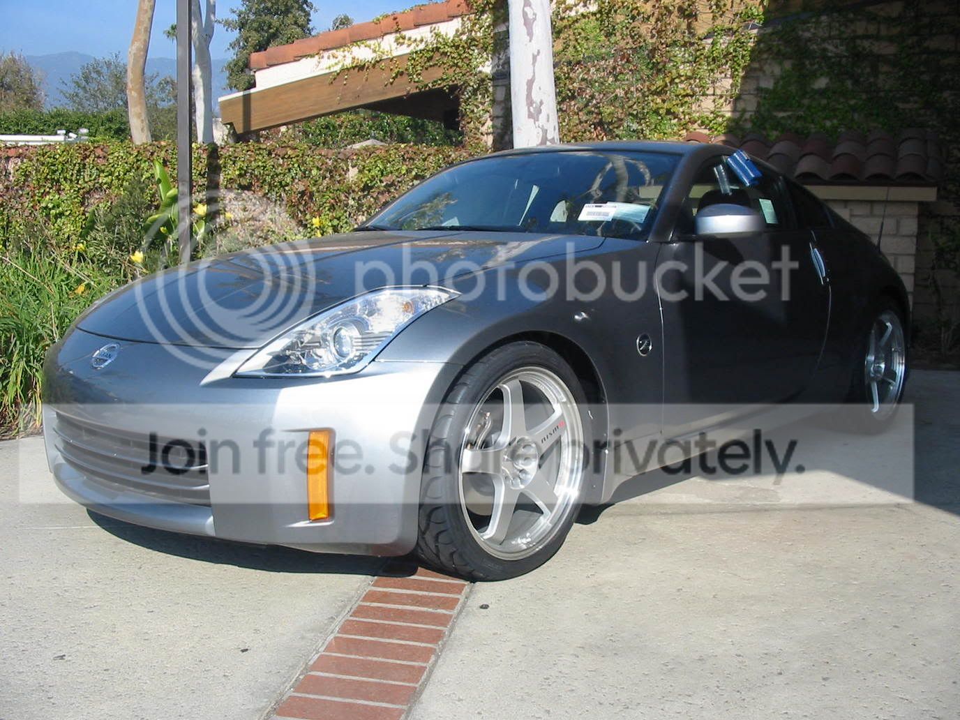

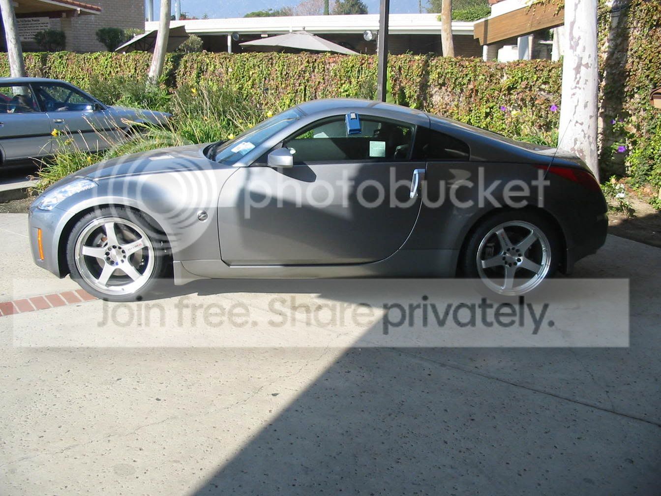

Here is a picture of 2006 350Z we built for new car sales. It is equipped with Nismo S Tune suspension, 19 inch Nismo LMGT4 wrapped with BFG KDW2 NT, Nismo S Tune exhaust, Nismo S Tune drop in filter, Nismo shift ****, Nismo frame. You can see from the picture what the drop looks like on 19 inch LMGT4. We built the same car for FastZ33. The S Tune suspension is pretty conservative and entry level compared to some of the coilovers that are on the market. The dampers are manufactured by Bilstein so they are very heavy duty and comfortable as far as ride quality yet stiff enough over stock to have fun with them at the track. The suspension is very comparable to the Tein Basics, just no adjustability in them. The reason why it is not lowered too much is because for Nismo to label it as a S Tune product, they have to keep the center of gravity within stock specs to allow the product to stay within the parameters of not voiding the factory warranty. All Nismo S Tune products do not void the factory warranty and has an actual warranty on the part itself with a 12K/12 month warranty.
