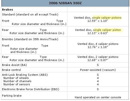

I sure do....you can't contest the facts.

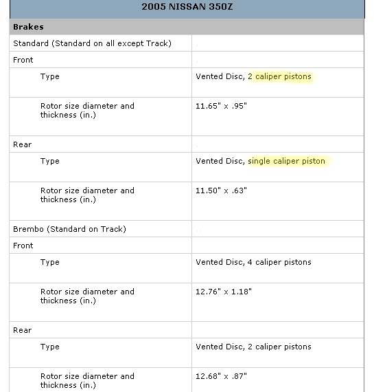

The 05 non-brembo front/rear is one piston, I'm fairly certain of it.
Old Jan 28, 2006 | 02:35 PM
mutock's Avatar
mutock
Joined: Nov 2005
Posts: 114
From: SF Bay Area
And you'd be 1/2 wrong...
Attached Thumbnails Are the Rotors on an 06 the same as 03-05?-calipers-2.jpg
You sure that's not a typo? The 03's and 04's have single piston. It doesn't seem likely that they would add them for 05 then take them back to single for 06.

Here's the source of my postings that I here-to-fore believed to be accurate:
http://www.nissanhelp.com/Models/200...ifications.htm
If there's any spec here that is known to be incorrect, lets uncover it so we can use these specs with confidence (albeit redlined).
