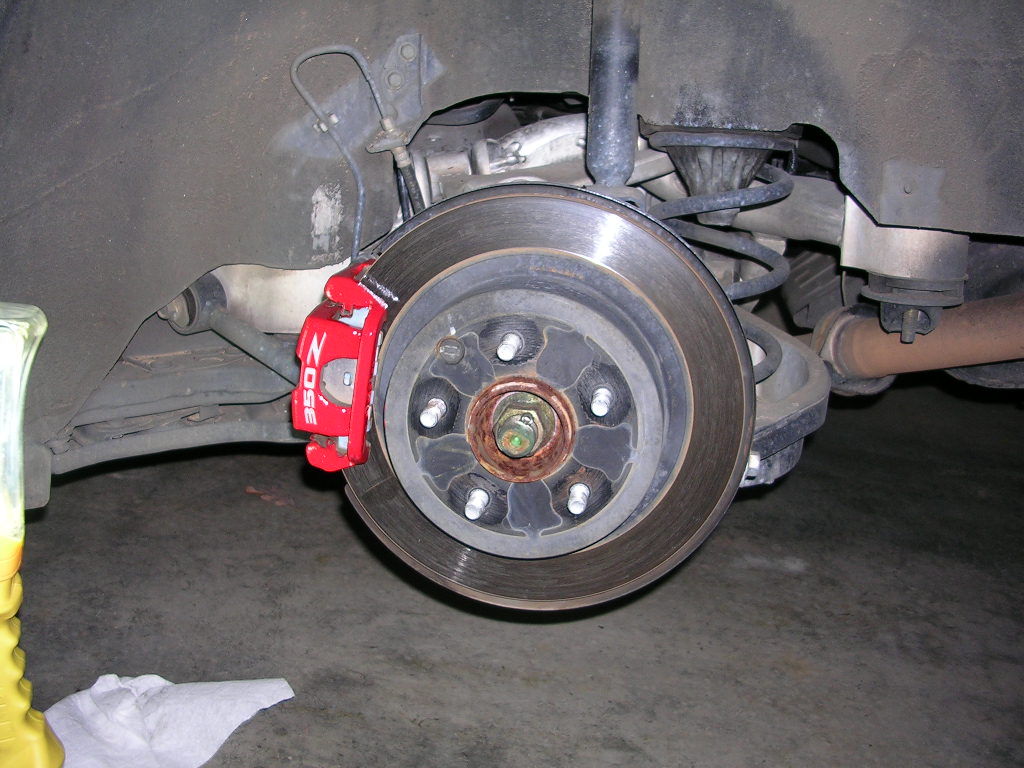

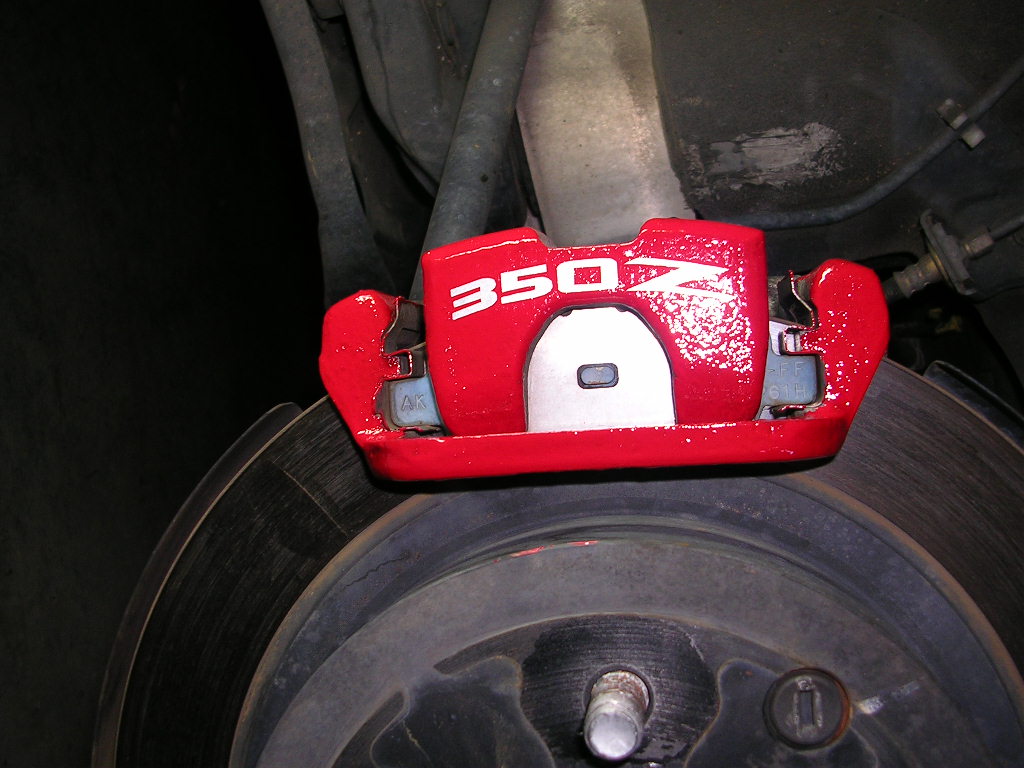

They are the "regular" ones. Here's a pic of how they look now, but I'd like to do a better job on them.
