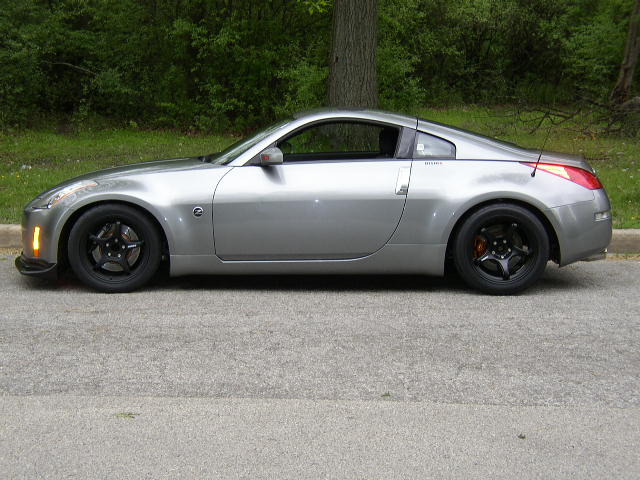

What the H*ll are you talking about Jeff? It's ALL about looking fast!
Damn, I was hopping I'd be alone with these wheels a bit longer...
Nice and mean Enthuz !
Thanks, it's all your fault that I bought this set-up!
Now to adjust the suspension to remove it's current high speed understeer.......
