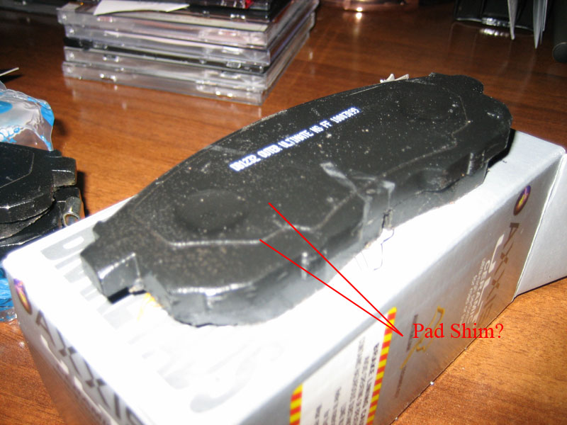

Attached is a picture of the AXXIS pads im installing with my Stoptech Stage 2 kit. The question is, on the pad itself is that a shim? and would i need to install my oem shim on to them?
Ill be install the kit Sunday.
Thanks

I honestly don't remember the pads but do know that I installed them with the OEM shim.
