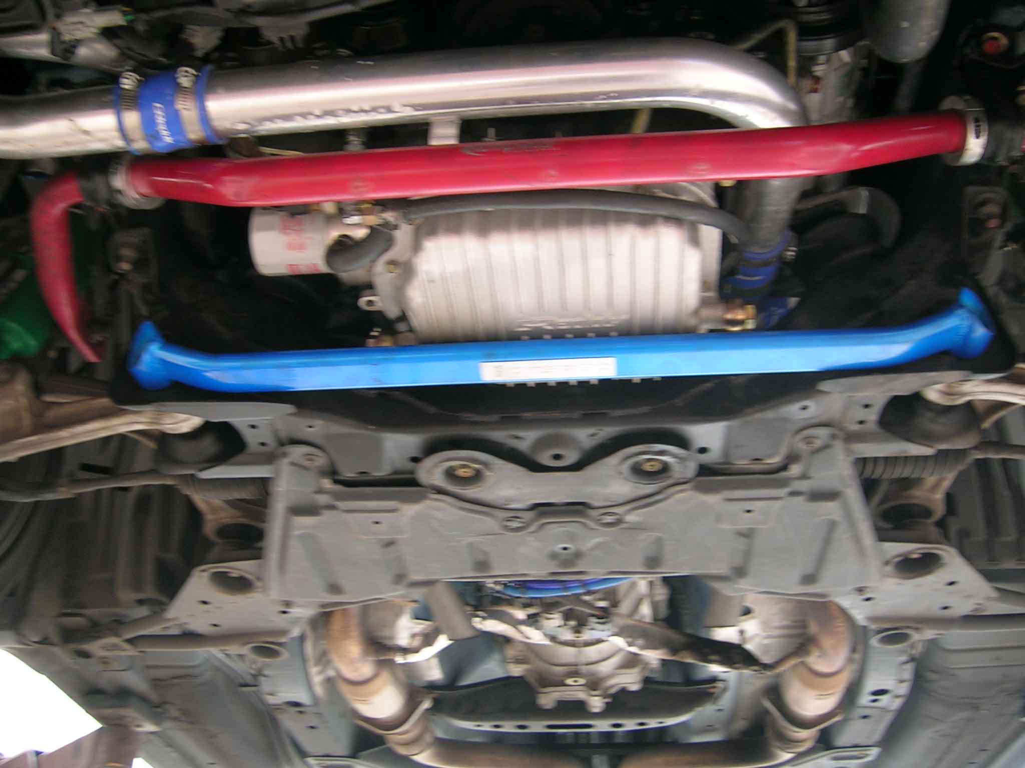

OK I found one.
I found this in a different thread than I was thinking though and am not sure if it's the same pic as before. Mostly because that sure isn't the APS oil pan in this one as it doesn't look finned.
It's not the stock one though either, so what oil pan is this?
Attached Thumbnails New Toys for SEMA: GT Spec Bars and SPL Front upper control arms!-front-20lower-20brace.jpg

^ I think it says GReddy on it. You can see the logo just over the GT bar.

I thought that may be it, but wasn't 100% sure.
Is the Greddy same capacity as stock?
If so, that would explain why it fits.

Yup, Greddy is stock capacity which is why it clears the GT Spec bar.

yeah that's a greddy pan, APS is just too big for the bar
solid motor mounts pretty much do what this bar does though, except the brace point becomes where the mounts are, made a huge huge difference on my car
