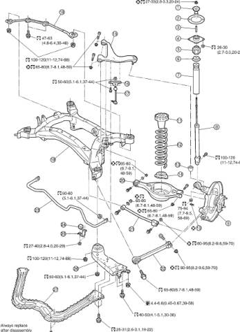

I had seen of pictures in the back from people who have installed exhaust or brakes, and I could see those springs sitting way in there beyond the wheelwell. So I was wondering, if you get a set of "coilovers", do you take out those inside springs in the back?
I imagine the front piece is the typical "strut" running up the center of the spring, which is what a coilover looks like. So I didn't have any problem visualizing the front. It was the back that had me lost there.
So, the Eibach set (for example) has the front springs for the struts (remove from car, compress, remove spring, place new spring, decompress, back tot he car) while it would have stand alone springs for the back.
It all makes more sense once you see the picture. Thanks.

Maybe that is the whole reason behind all this. I am an older guy so I came from :
- leaf springs, regular springs and shocks everywhere... to
- Struts (McPearson style), which I have never seen used in the back, only front... to
- Coilovers (SHOCK through the spring/coil to save space)... to
- Adjustable "coilovers" which could resemble adjustable struts....
etc, etc... Like I said, I wouldn't understand how you go from spring/shocks to "coilovers" in the rear.
So, and forget how many mistakes I just made above, what DO we have on the 350Z?
- Front look like McPearson (sp?) struts to me.
- Rear is a spring/shock combo.
Correct?
