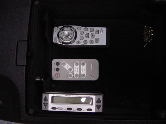

here is a pic of my edfc install:
Attached Thumbnails Got my TEINs installed, help from other TEIN owners pls.-edfc-001-small-.jpg

Old Apr 5, 2003 | 06:20 PM
Chebosto's Avatar
Chebosto
iTrader: (43)
Posts: 10,681
From: Redondo Beach, CA
Yea. its the plastic parts. i have to do some Dremel Time to cut grooves into the plastic for the wire to run so they're not whacking into everything.
as for SkiDazzle's install.. where's the GLOCK!?!
VQ: no elbow bump.. i was thinking of making a flip top out of brushed aluminum....
