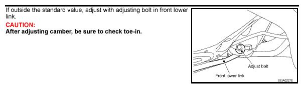

wow... its the same as my last 4 cars... what are you looking for?
here is the text from the service manual for rear suspension (RSU 5-6):
CAMBER INSPECTION
Measure camber of both right and left wheels with a suitable
alignment gauge and adjust in accordance with the following
procedures.
Standard value
Camber : Refer to RSU-18, "SERVICE DATA"
REAR SUSPENSION ASSEMBLY
If outside the standard value, adjust with adjusting bolt in front lower link.
CAUTION:
After adjusting camber, be sure to check toe-in.
(there is more information on how to adjust toe in the rear also)
here is a pic of the bolt to adjust for rear camber...

Ok, so its an oblonged hole. Still that is very minimal adjustment for most drops. JIC wouldnt sell rods if our cars didnt need them
I should have looked at the service manual before responding. Sorry about that.

The rear camber IS adjustable, not very much though. I lowered my car 20mm (instead of the 10mm suggested by Tein) and I could only go back to -1.9 max on the rear vs the -1.33 stock spec.
