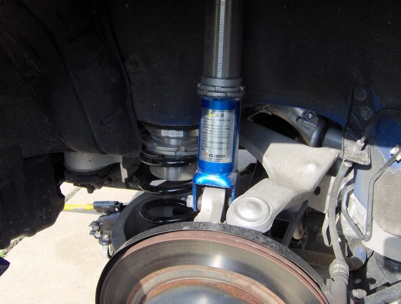

Here is a picture of the coilovers at the suggested height. As you can see, it looks perfect.

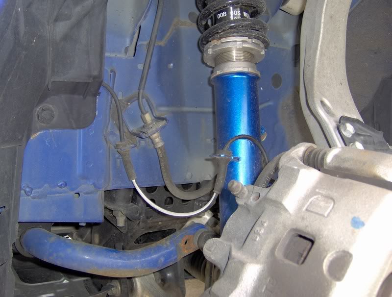

Notice the large amount of corrosion on the front and rear stabilizers in the pictures. However, in their defense, look at all of the rust on my rotors. I do live in Delaware where they salt the **** out of the roads every winter. BTW - They were as bright as the coilovers are now when I bought them.
Adjusting the rear dampening sucks and takes about a half hour. With only five settings, I debated for a long time whether to get the Zero-1 or Zero-2. If the dampening on non-adjustable Zero-1's is equal to the middle setting on Zero-2's, then maybe I should have saved the couple hundred bucks.

Originally Posted by black06z
holy crap, that's a lot of rust for such a short period of time.
Considering the environment sways live in....they will never stay pretty for long unless you never drive the car
