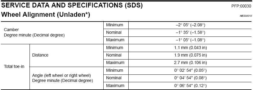

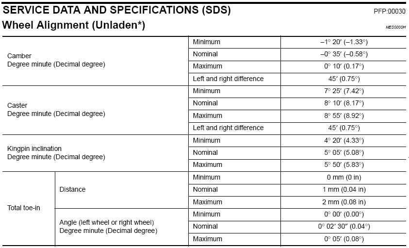

I just lowered my car with H&R Sport Springs and SPC rear camber kits and front control arms. I'm going to be taking it to an alignment shop tomorrow morning, and I want to make sure they are doing everything right. What are the factory specs for the 07 Z so I can tell them to aim for?

Fully described in your downloadable .pdf FSM.............24 hour fee ~~ $20 from Nissan.
Alignment machine companies send out new specs every 30 days to load into alignment computers.

Front then Rear...
Attached Thumbnails 2007 Z Factory Alignment specifications?-fsu07snap.jpg   2007 Z Factory Alignment specifications?-rsu07snap.jpg

Note the 0.58 degree camber as the nominal DESIRED setting on front
