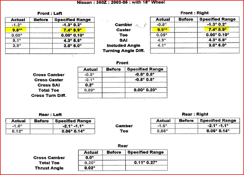

the service guy didn't include the before data (which i was very curious about, of course)...can you guys help me interpret the after results? i highlighted what seems strange...the caster is out of spec on left and right, but then the middle column says it's fine. i just don't know enough about alignments to judge this.

Not bad, they could have done a little better job on the toe in the rear left to get it even with the right. Did you they ballast the car to account for your weight in the driver's seat?

not sure if they compensated for weight in the driver's seat...but i can guess they did not. they didn't mention it (or ask me for my weight) and i didn't know about it to ask (but it sounds like a good idea...sigh).

more camber for wader wheels and better cornering
