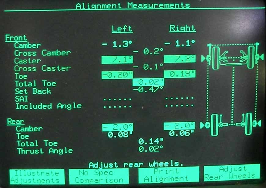

I lowered my car by only .6" and this is what I ended up with...( no changes were made. The alignment was just "checked" after the spring install)
Because I autocross, I like the extra negative camber. You will get much more being even lower. (maybe too much)

whatever the front caster and camber come to be. .there is no adjustment for it less you buy the control arm with the adjustments on it. .but the front hardly ever changes. .lowered or not. ..
