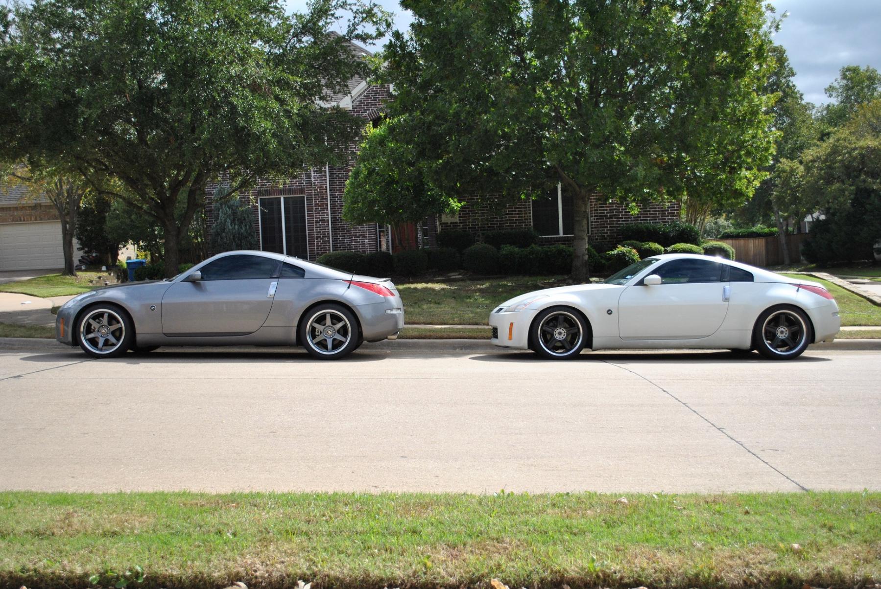

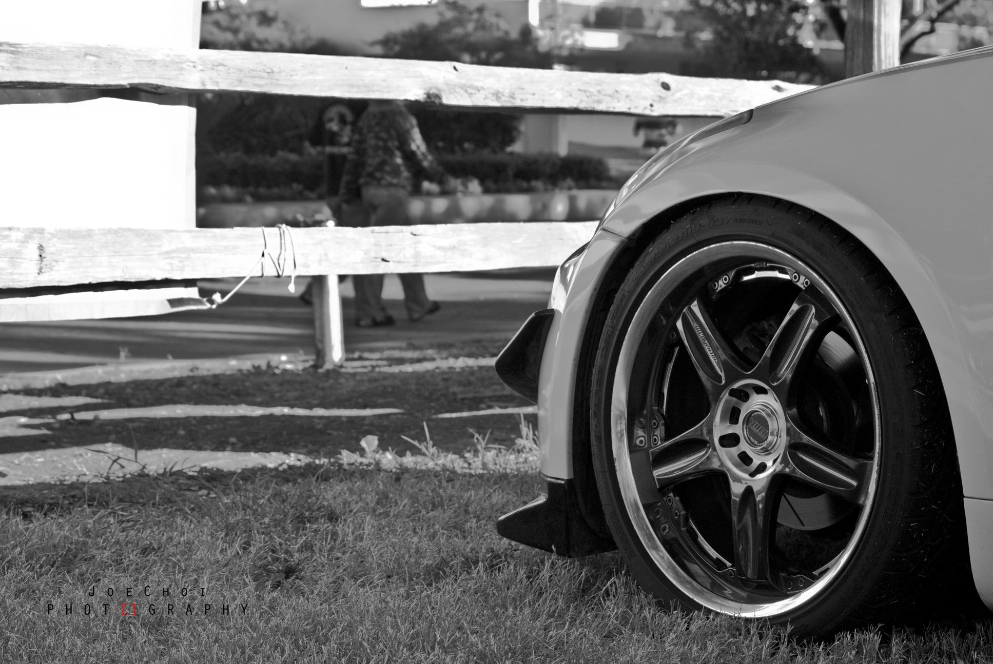

Updated thoughts on 1st post.

I have rode on this set for nearly 50k miles (daily driven) with no issues at all. Not sure what you're planning on using it for but I would recommend it for street and maybe some track use here and there. If you plan on dumping your car and stretching your tires, look elsewhere.

buy them, you will have no regrets unless you want to lay frame. these coils go low with the collars removed, but going that low alters your handling negatively.

^ What Duckeee said. Those pics on post #25 are the lowest I can go I believe without compromising my rebound capabilities.
