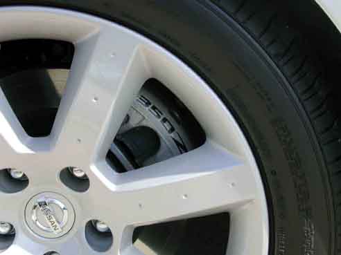

JUST PAINTED MINE USING A SILVER G2 PAINT KIT AND BLACK STICKERS FROM JVD GRAPHICS. HARDEST PART IS JACKING UP CAR AND PUTTING ON 4 STANDS. I HAD ENOUGH PAINT FOR 3 COATS.
ENCLOSED ARE FRONT AND BACK PICS.

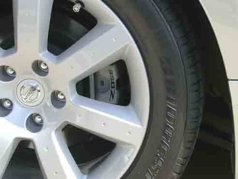

Old Aug 25, 2003 | 06:54 PM
MIKE3348's Avatar
MIKE3348
iTrader: (55)
Posts: 92
From: BRUNSWICK, OHIO
REAR
