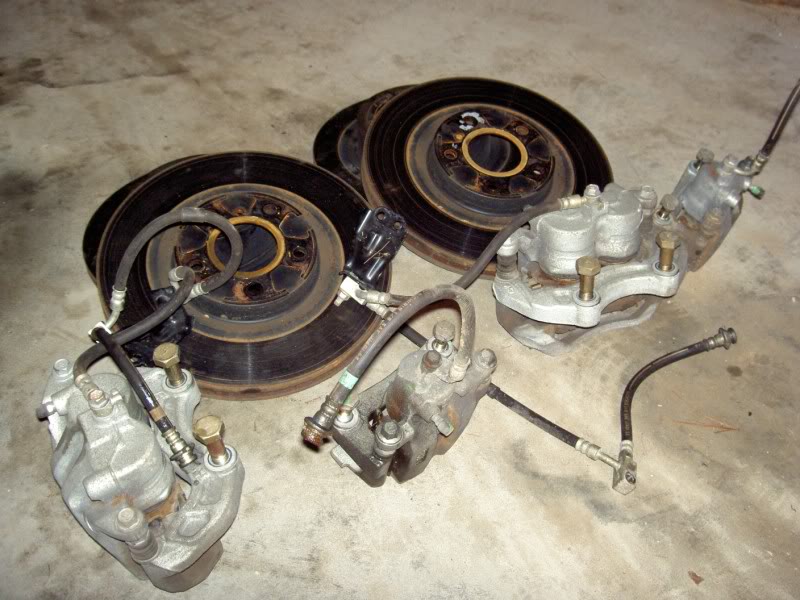

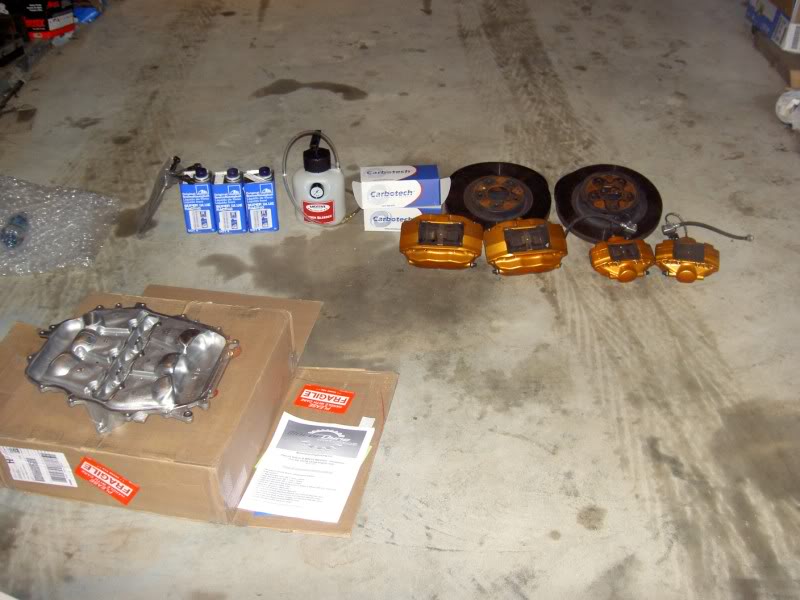

So a few weeks back I purchased a set of OEM brembos from an 07 Z with ~10k miles. I figured since I was going to tear the whole thing a part, I might as well spring for new brake pads, stainless steel brake lines, and fluid as well.
Pads used: Carbotech AX6 front and rear

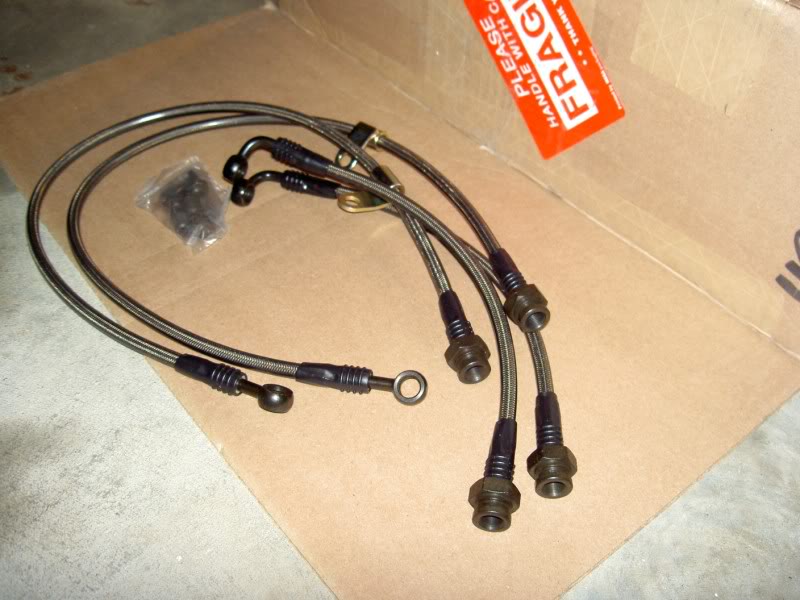

Lines: Technafit for OEM Brembo

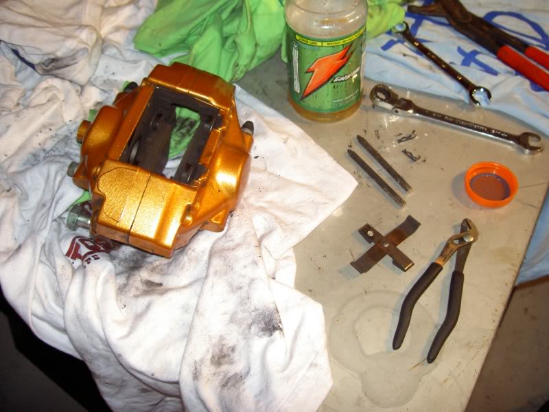

So after getting the car in the air on jack stands i prepped the new calipers. I collapsed the pistons pushing the old fluid out, and changed out the old pads with the new Carbotech pads. I tried to take as much of the old brake dust off as I could, but without a part washer it was time consuming.

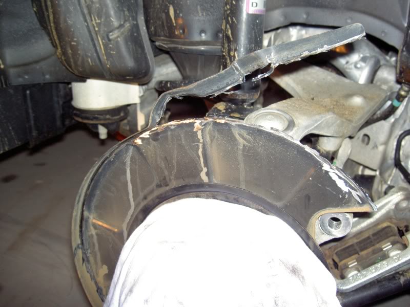

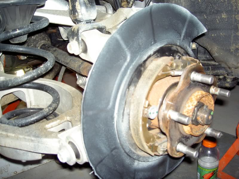

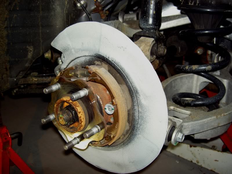

On the rear brakes, the dust sheild has a lip around which forms a sort of "dish" for the rotor to sit in. With the new larger Brembo rear rotors this had to be cut off. An air die grinder with a cut off wheel made short work of it. A pair of good tin snips would have worked, but I do not not if the final result would have been as neat looking. Once I cut them off, I took a angle grinder and smoothed out the jagged edges as best I could using a sand paper flapper wheel.
To protect the raw metal I applied some cold galvanize, and then some dark silver metal flake high temp paint I had laying around.

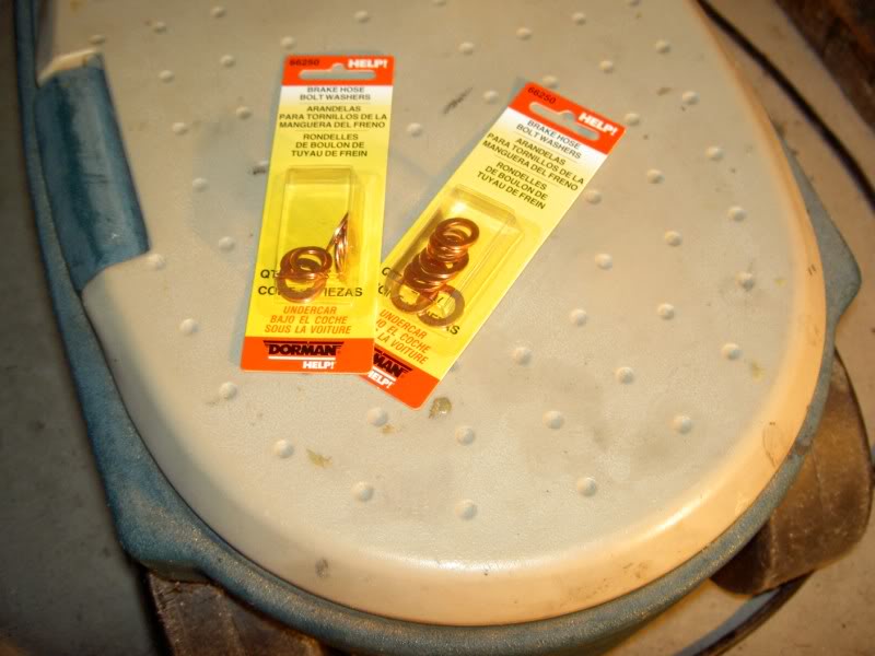

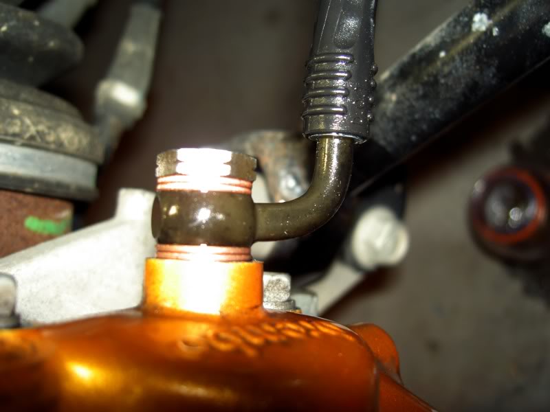

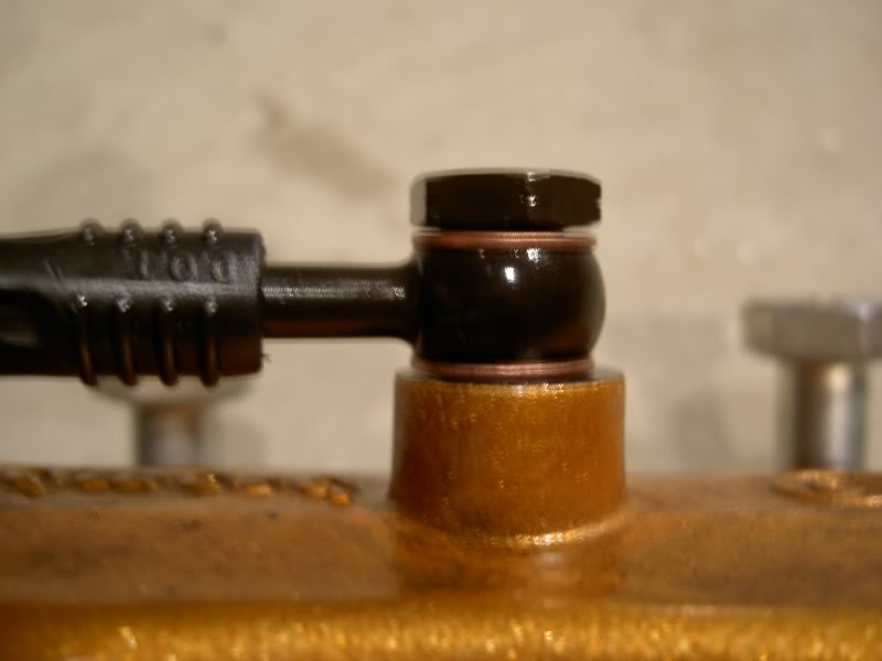

Now it was time to put the new calipers and brake lines on. I had everything set to go, pulled off the lines, put the new right rear calipers on, attached the factory brake line and then went to tighten the banjo nut on the caliper itself only do find out that it would not tighten up. The POS screw was about 1 or 2 millimeters to long to work with the supplied copper crush washers. I was pretty pissed to say the least. I ended up getting some extra copper crush washers from advanced auto parts and had to double up the washers between the fitting and the caliper. This allowed me to tighten everything down. I did the same thing for the rest of the calipers, front and rear and it seems to be working fine. I will be checking it closely just to make sure nothing starts to leak.
I searched the forum and found this problem has happened with the Technafit stainless steel lines in the past. It seems like they have a track record of packaging the wrong machine screws for use with the Brembo calipers. I will be calling them to see if I can get the correct hardware, but in the meantime everything is bolted up.

This was the quick fix to keep it from draining the master cylinder while I got extra washers. When I reinstalled everything I only put 1 washer between the fitting and the machine screw head.

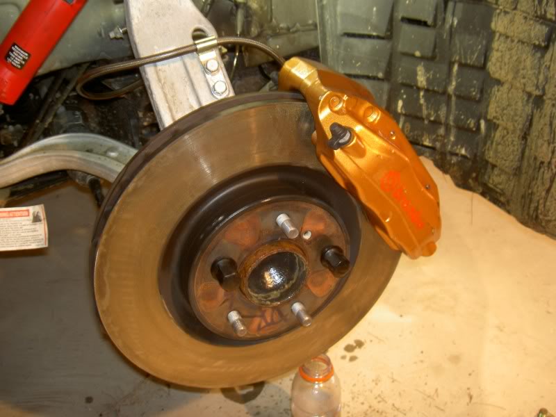

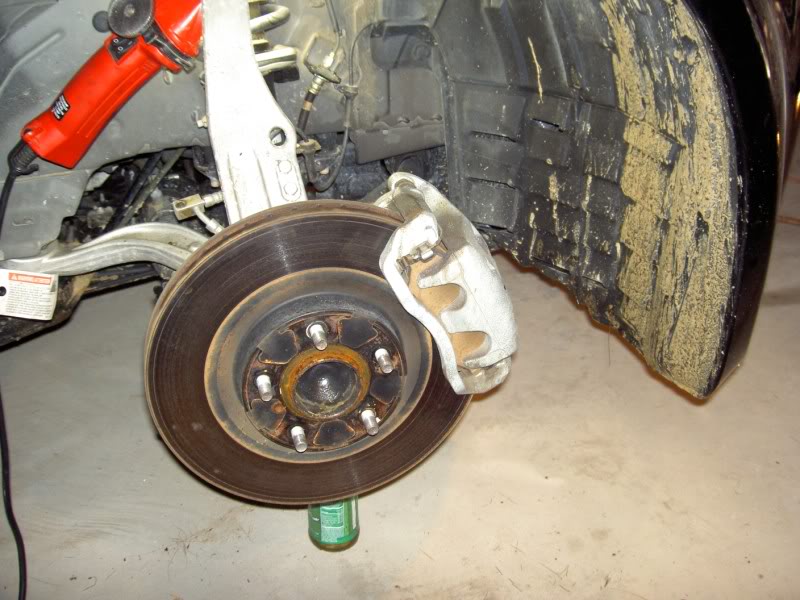

Final Results
Before:
After:
