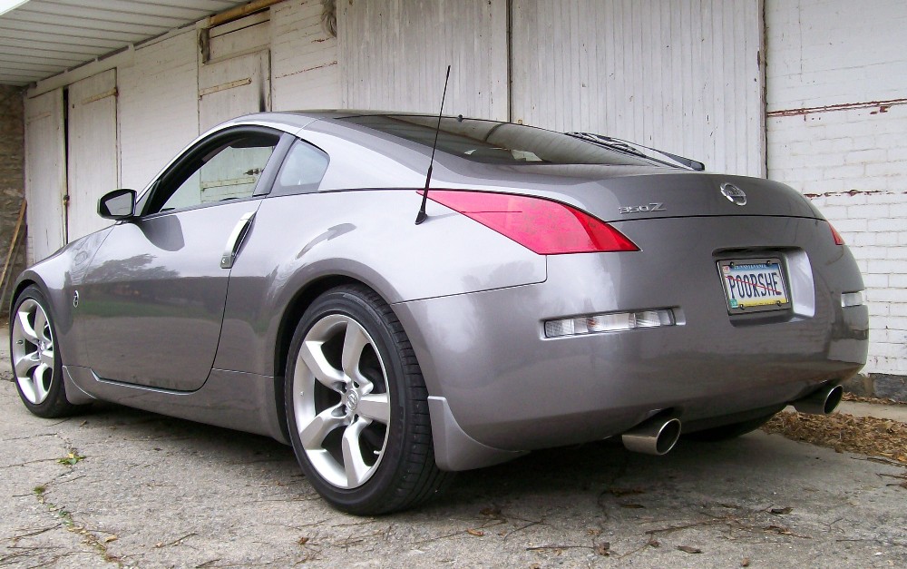

Default Tein S techs
...about 3/4" drop. Also 15mm/20mm spacers F/R.
