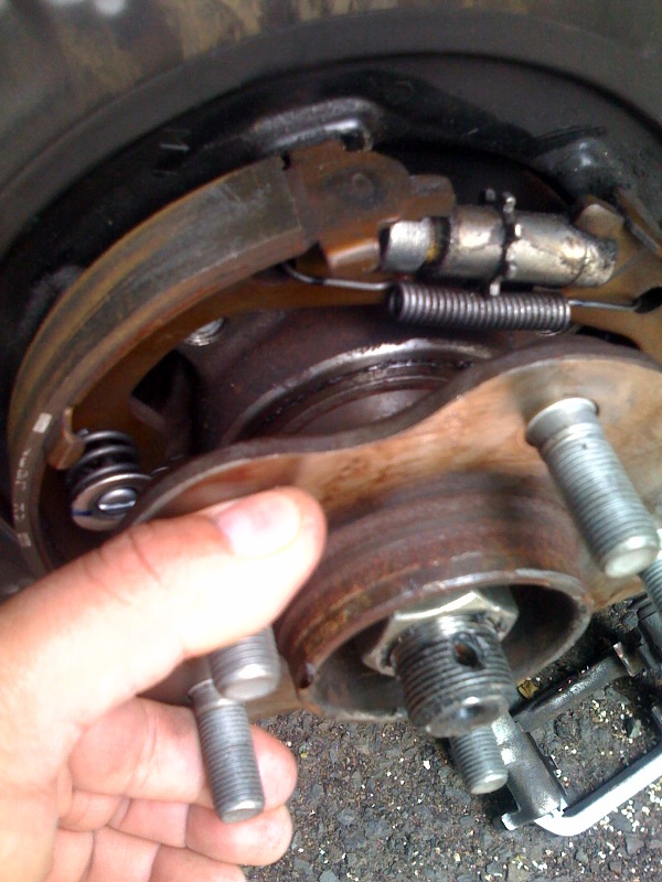

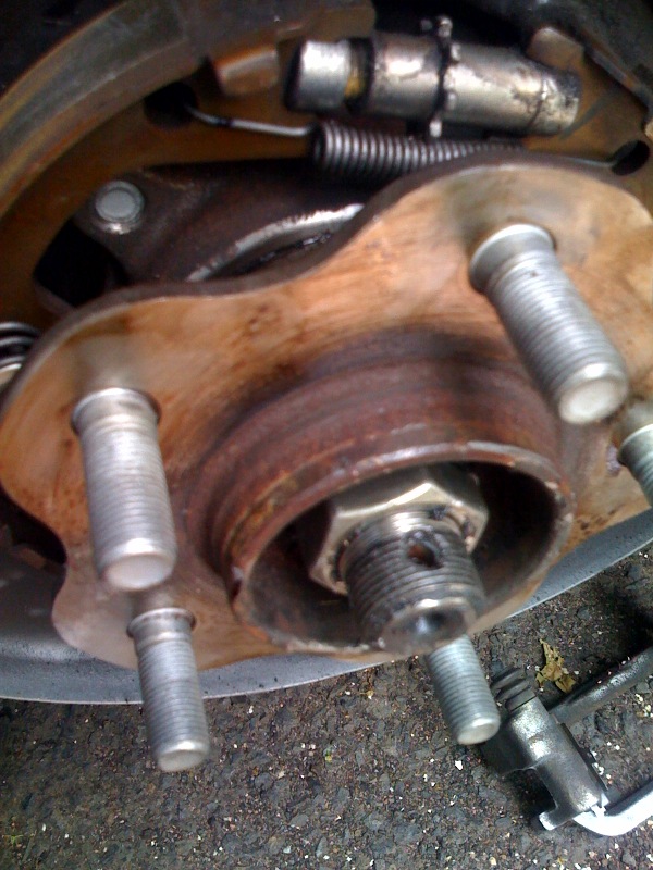

I think i found out the problem to my problem, looks like the wheel bearing nut was loose. does anyone why the right side was loose and the other side is not?

Bought the car used? It seems like someone works on that axle before. Looks like its missing the cotton pin and different axe nut to me.

i removed the pin my self to put the axle nut in place, i bought the car brand new my guess is some mechanic played with the nut.
