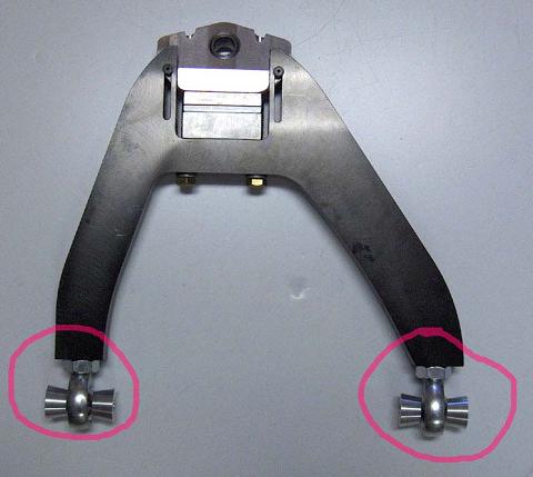

Be patient with getting the bolts in on the upper, I put the struts in location first, and got the lower bolt in, then put the A-arms in, and moved the strut forward/rearward to get the A-arm inner bolts in. The spherical bearings were a bit tricky, lock them in place BEFORE installing them on the car, I didn't do this the first time, and realized I couldn't get a wrench on the lock nuts, and had to remove them from the car, redo, and reinstall.

I assume you are referring to the side which connects to the firewall (and is used to adjust caster)?

Exactly, otheise everything went in easily.
