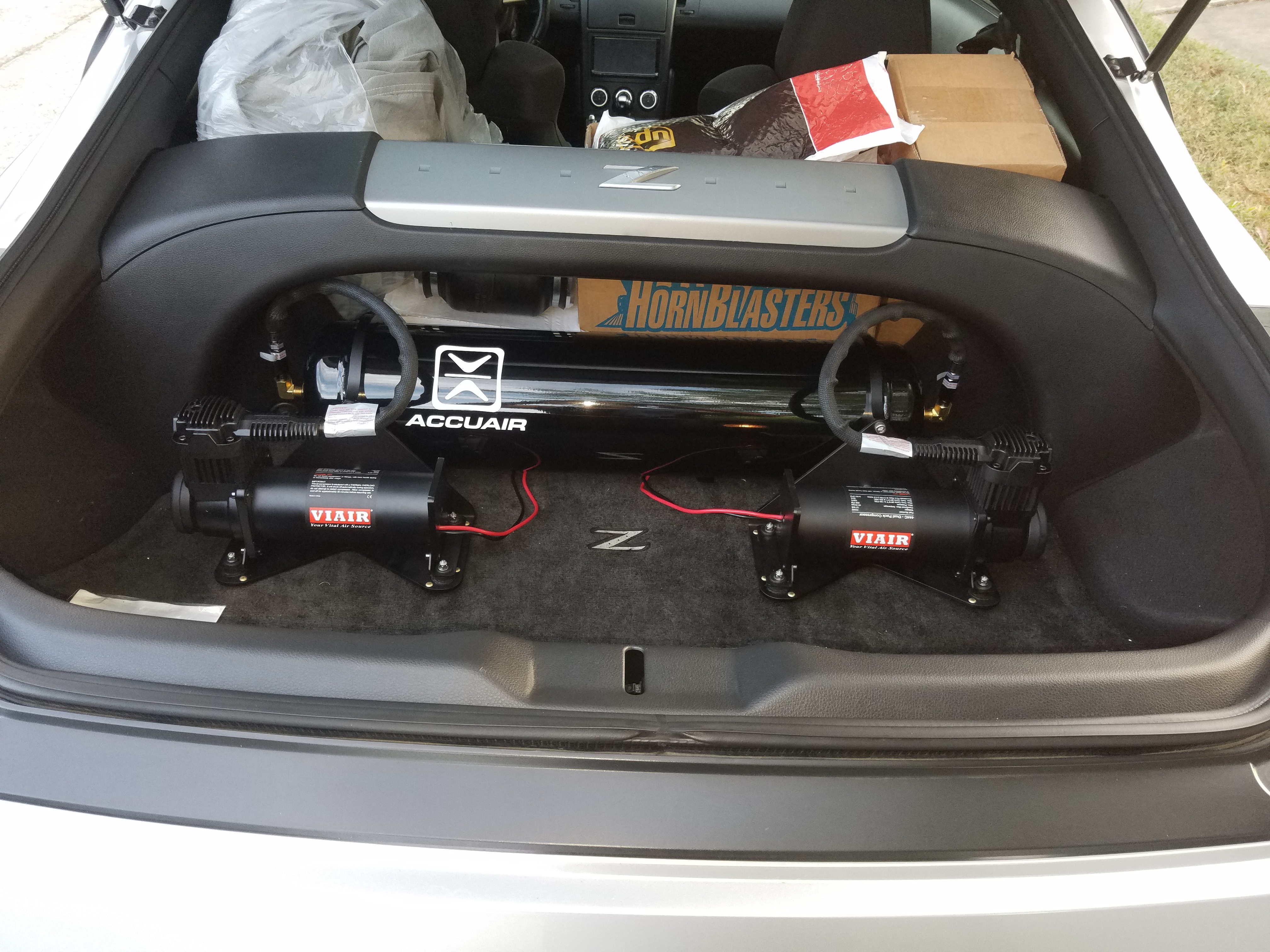

Getting ready to bag my 08 350z this are my parts
Universal air bags front and back
Bagriders.com brackets front and back
accuair exo mounts
Accuair air tank
Accuair vu4 valves coming soon. I'm using a set of 1/2" valves thar are for my chrysler 300 for now
Viair 444c black compressors
Viair dual relay
Viair pressure switch in route
Slam specialties control box
D2 coilovers
Don't know what gauges to go with yet digital or analog
Two water trap no name
Im just waiting on my fittings to come in.
My question to the guys that have there 350z on air how did you all go by running your air lines under the car which route did you all use. I seen some one run them inside the car but it was 1/4 lines then drilled holes to the outside or used factory holes but I don't want to do that any help would be great. I already have everything wired and it's working. And I know I will have to drill holes in the rear where the spare tire is I just want to also know what you guys did so I can get an idea thanks.
