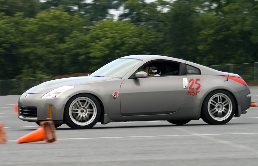

..actually had them on in 30 minutes, no wheel removal no muffler removal. After I loosened the old bar, I was twisten' and turnin' it this way and that and just as I was about to loosen a muffler hanger I spun it about 90 degrees from the normal axis (now in the same line as the drive shaft and after a move or 2 just about fell out.....WOW!
Now I made sure I put the new bar in with the same orientation and it worked.
Took a test ride up my favorite test road The Duryea Hill climb here in Reading PA and I was pleased. Push seemed to be gone and I could put power down early without the rear breakin' loose. I'm full soft (1st hole) in rear and medium soft (second hole in front)
I'm on a square setup 245x 18s all around with 8.5" Enkeis
The next AX is in a few weeks and we'll see how I line up with my regular competitors....
I'll be running STR next season....
