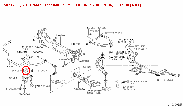

Were is the part 54613?
Old Nov 19, 2009 | 04:17 AM
thinking's Avatar
thinking
Posts: 248
From: Right Here
Circled.

Yeah... I was actually asking were was the part on the car not the picture. I couldn't circle it on mine, sorry for not specifying.
Old Dec 2, 2009 | 07:08 AM
Zenpato's Avatar
Zenpato
Posts: 568
From: under ur BED!!
That looks like the black urathane bushing that goes on the sway bar.
