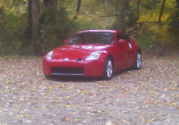

Thanks guys!
Yeah, I think new shocks are a must. I've been starting to notice that bumps seem to hit a little harder than they used to.
Probably going to invest in some sway bars as well. Why not right?
All in all its been a great car. 120k on the suspension.. 85k on the JWT Clutch Flywheel Kit (grabs everytime, no slip) & 70k on the Engine and Transmission. That last one is another story all together.
Running it till it dies.
