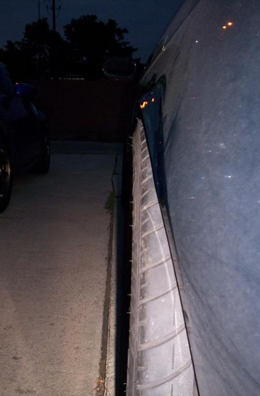

Ive done a few pulls here and there...
that was my first one.. but alot of heat alot of angle help to get that pull.. patience is key when getting both sides just right..dont want one side to have more pull than the other..etc..

Thanks for the pics. You are a brave man, I dont think Id try that on my Z.

wow. s13/14 rears have a tendency to dimple when you pull it.. how'd you avoid it.. or is there a slight crease in the reflection?

Really, I just took my time - I didnt want to fug it up..used the heat gun religiously and it turned out that way...there is a crease from the lip being pressed so hard with the roller (if thats what you meant)... I heard of that dimple thing too so I was a little worried about that..took longer but it was worth it..customer was happy..
