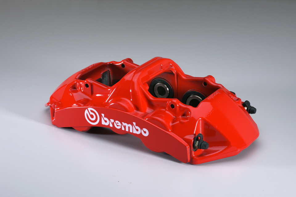

I've got this front caliper(aftermarket brembo 6 piston caliper).
These calipers need radial mount brackets for installing on Z.
But, I can't find part NO. of brackets.
plz, help~~~

is there a part number on the caliper? you might be able to call brembo and give them the caliper part, and in return get the part number you need from them.

regardless of whether you have the brembo part number or not, you should contact brembo. they will be able to identify that caliper for you and help you get other parts (fittings, etc.) including bracketry

Brembo will never supply a bracket.
You will need to design your own.
I can supply a set for the front that we designed.
It'll run about $1200 shipped.
I've been there and done that. This is a waste of time.

Here is what my parts list call out:
Lh caliper p/n: 20.9736.31
Lh bracket p/n: 90.2703L
Rh caliper p/n: 20.9736.41
Rh bracket p/n: 90.2703R
Let me know if you need any part number that comes with the kit.
Good luck man, contact Importedperformance, i'm sure he can help you, he got me my rear brake kit to match my front.

It will depend on which rotors you plan to use (diameter and offset), but chances are, you'll need a custom bracket like lgear said.
I have a similar appearing set of calipers, and I had to design my own brackets.
