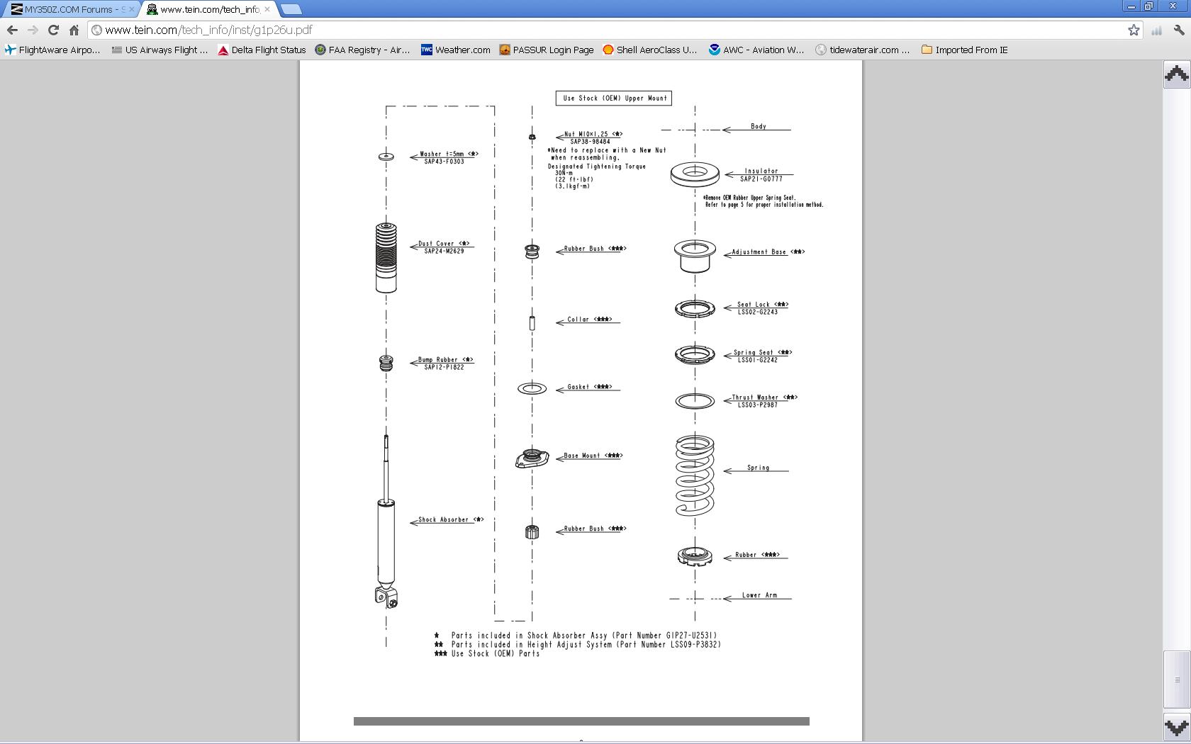

Originally Posted by Vivid Racing
I used to work for a big coilover company and I've seen almost as many coilovers with perches missing as I've seen with all the perches intact
As long as the perch is tightened against something, it's fine.
Got a link to this? The only Z's I've worked on were on coilovers. I have no experience modding OEM suspension. I've ridden in and driven Zs on lowering springs, but never installed them on the Z.
EDIT: I found the DIY. That part that is cut is actually completely removed when installing coilovers and replaced by an adjustable metal sleeve. Check the pic below, it's the gold part. You use the green collars and perches on the gold sleeve to adjust ride height.
Some coilovers use a "true coilover" aka "full coilover" in the rear, which completely bypasses the stock mounting of the spring and places the spring right on the damper, like the fronts.

Originally Posted by TucsonG35
the newer basis coils DO NOT require use of the rear upper mount. but the rear drop is still listed at only 1.5
Instructions say you do. Did you receive something different?
