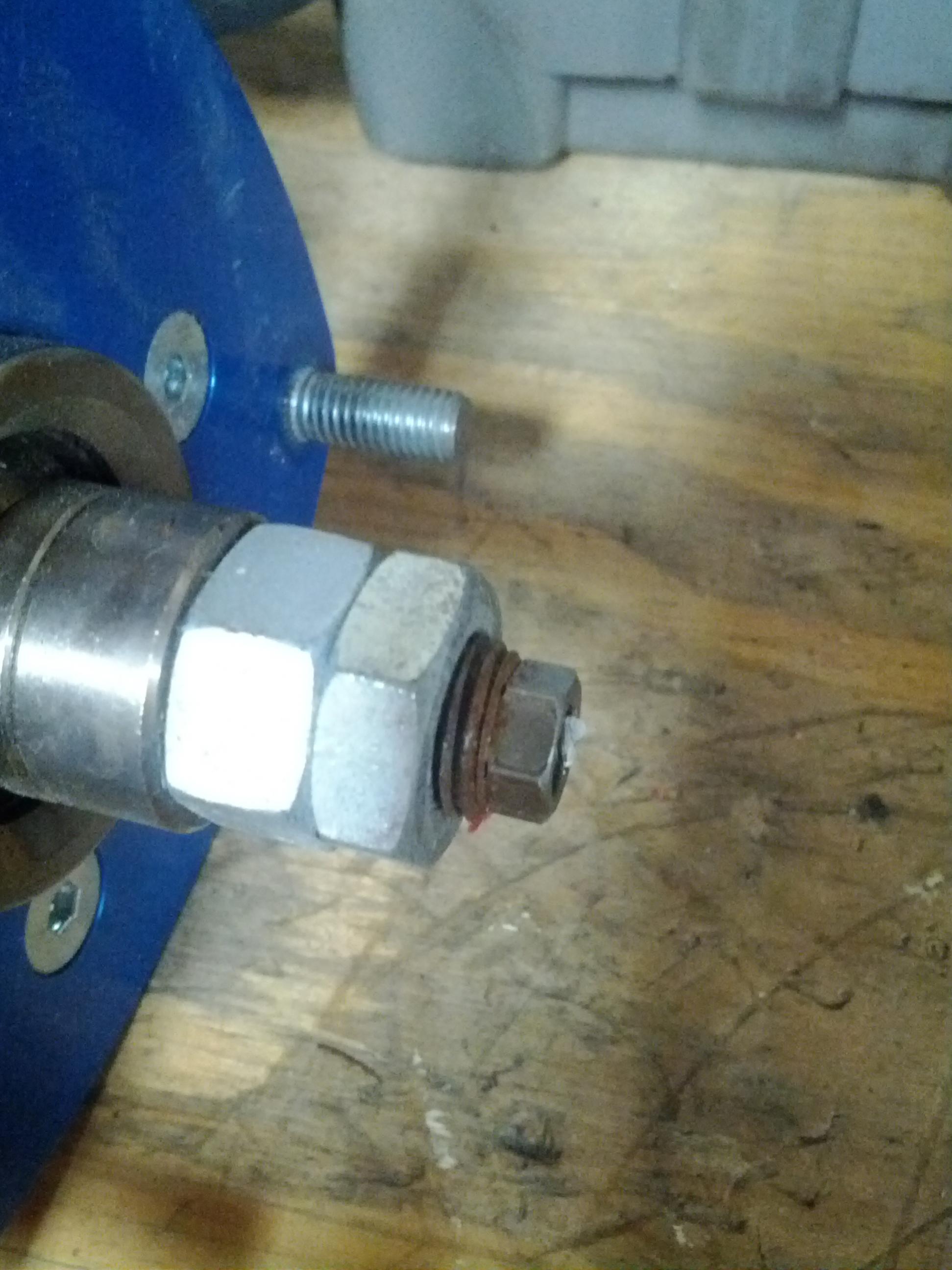

Hey all. I was doing some work on my car today and somehow when I was removing my coilovers the adjuster on the top of the shock that adjusts damping broke off. I am not sure how I did it, but regardless, it happened.
These are Zeal Function X coilovers. There is still thread down in there, but the **** broke off. How can I replace this? Can I un-screw the small nut in the picture that it threaded into and try to get the rest of the thread out and just replace it with a bolt of some sort for now? Will that release pressure in the shock?

Having issues getting pics loaded, so I am trying in another post...
Attached Thumbnails Damping Adjuster Broke Off-img_20120424_195418.jpg   Damping Adjuster Broke Off-img_20120424_195423.jpg

I'd call up Endless USA to see if that's how you would replace the adjuster before you do anything. Most likely the nut you see on the end is what you'll unscrew. By the looks of it the broken off bit is just a simple allen key.

I actually got off the phone with them a bit ago. Bad news. It needs replaced, well that is if I want to be able to adjust it at all, which I do.
I thought I would be able to remove that small nut and replace that or that assembly, but it turns out, it is all one piece that slides all the way into the shock.

Well that's unfortunate. A lot of coilovers these days have a simple allen key style **** that doesn't go too deep into the coilover at all. Looks like you won't be adjusting the damping on your Zeals any time soon haha. At least you know it can be fixed though.

Bad news. I sent pics to Endless for the part that I need and now they're saying that part is installed during the manufacturing process and they will have to rebuild them. I'm not sure why that is the case, because you would have to remove this part when rebuilding the shock anyway. I would think they would have this part or at least be able to order it for me. Looks like it will be months again
