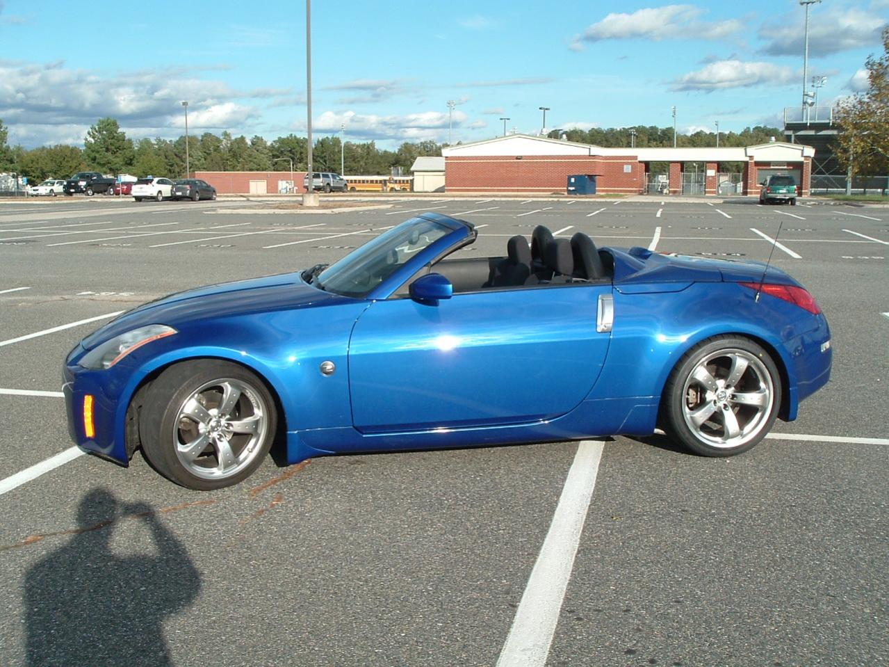

I've got a 2005 Roadster with Hotchkis springs and for the money love them. Lowers the front around .5 and the rear around .75 and won't beat you to death if you using it as a daily driver. Stock shocks are fine, but you'll need an alignment when your done. Keeps the car within the factory alignment specs (on the edge) without any additional hardware. Add a set of swaybars and get set to have some fun. Here's a pic.
