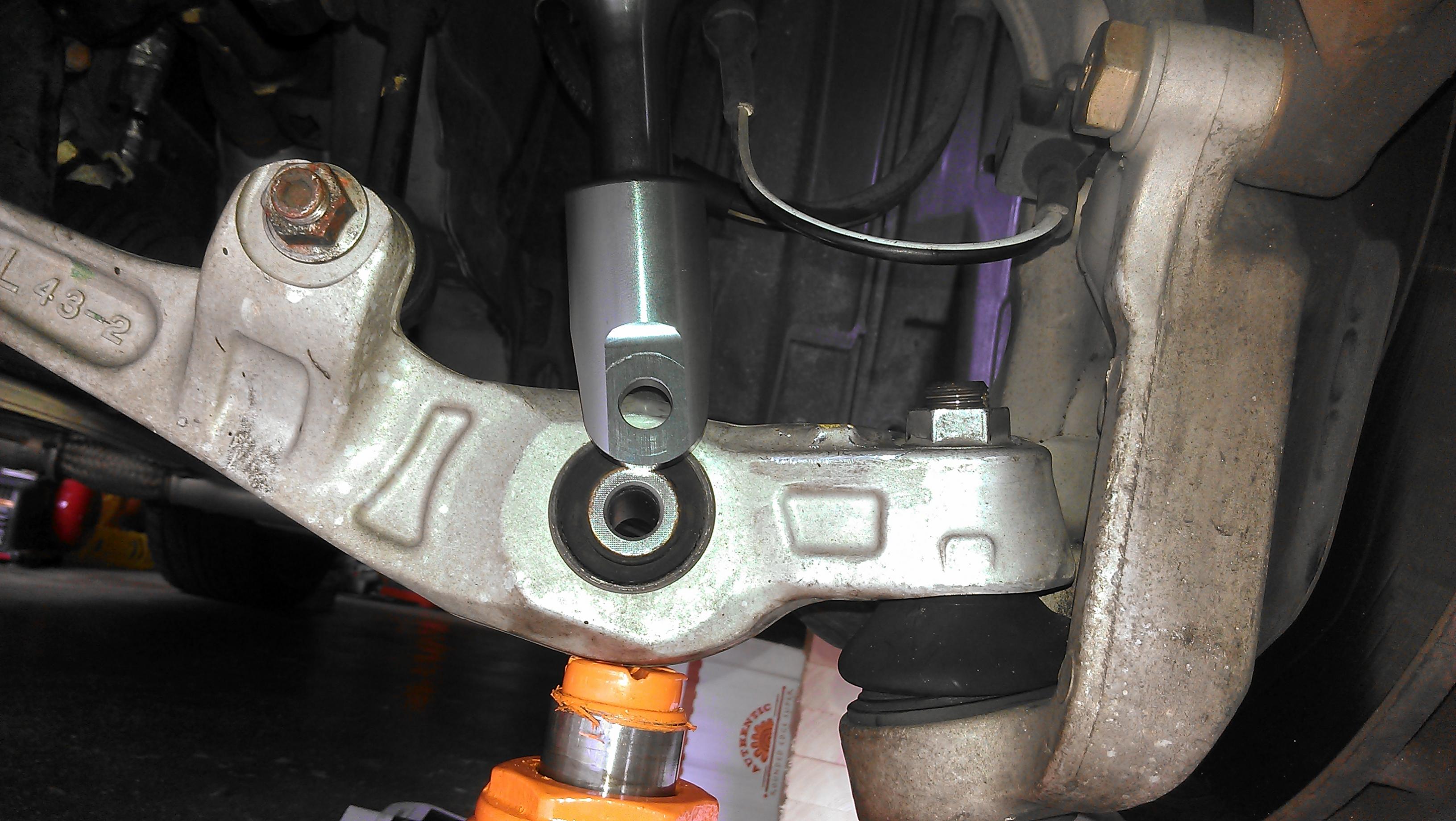

new coilovers set for 20mm drop at front ...question do i just jack the arm up to install bolt...seems to be putting a lot of tension on the sway bar link ????pic below

Disconnect endlinks from both sides first then jack up the lca to bolt up the coilover. When youre done with both sides of the car you can go ahead and bolt up the swaybar links.

^or just put both front wheels in the air. No risk of screwing your endlinks up.
This, except you only have to disco one swaybar side.
