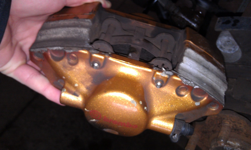

Pulled the driver side rear wheel off Wednesday to change the E-Brake Shoes and to my surprise I find this.
My Brembo Caliper was ground down due to the PO putting the wheel on without a spacer. I didn't notice until I took the wheels off for the E-Brake because the spacers were on at that point.
As you can guess I was not in a good mood.
So, on to the good news, the new Brembo Caliper should be here tomorrow by noon or 1pm!

That doesn't look like its from not using a spacer, it looks like he (previous owner) ran a smaller wheel (winter set up) and they didn't clear. Probably ran a 17" or 16" and rubbed until it cleared.

It was probably like that when he bought it. The PO must have been deaf.
Good point!
Jeez though,mdidnt notice it when washing the car?

It was like that when I bought the car. I didnt find it until Wednesday until I took the wheels off.

I'm guessing it's from a spare tire being used. If it's only on one side!

I don't know what it was for sure, but it was still a major PITA!

OP, Check your spare tire to see if it was the cuplrite

PO was running the spare too long, check your spare OP.

This doesn't make sense to me.
First off, why would Nissan give you a spare that doesn't clear the calipers?
Second, what's the difference between running it for a day or a month? The clearance isn't going to change.
I haven't had to use my spare yet, but I highly doubt it was caused from the spare. Like I said, I don't believe Nissan would give you a spare that doesn't clear the caliper. Unless the last owner used a sparre that wasn't meant for the car or like SR71 stated, it's from a different set of wheels.
Also, like King stated, how did you not notice when washing your car? I always make the brembos nice and pretty.

It was still working, it's just in terrible shape. It's not safe at all and I wouldn't feel right selling it or even just giving it to anyone to use. Plus the Brembos were aftermarket and so I'm not sure about the spare.

None of this makes any sense. For that amount of interference, the wheel would not have fit straight and would have wobbled severely (assuming it would rotate). Not to mention that if the PO would have tightened the lug nuts enough, it would have "locked" the wheel in place and wouldn't even turn.

Caliper came in yesterday. Replaced E-Brake shoes and put on the new caliper. Car feels much more solid and stops a tad bit better aha

Spare tire was the culprit. It has a ring around the inside where it is scratched and gouged to hell.
