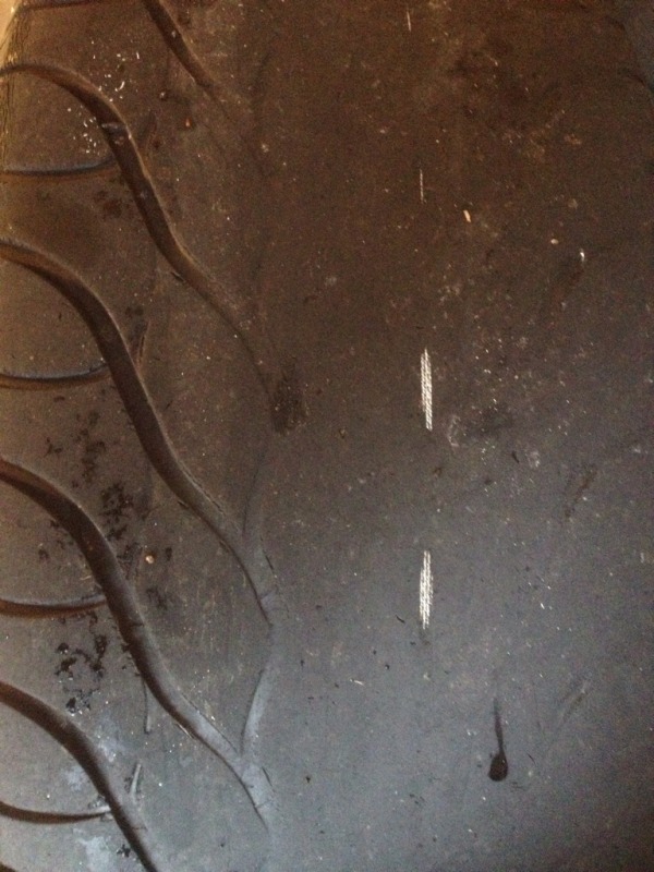

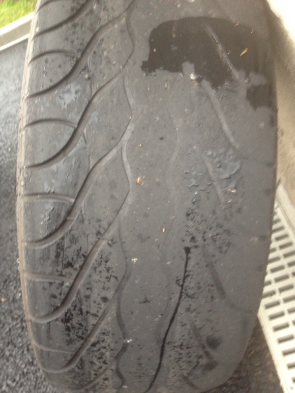

Hey all. I recently put on my winter wheels and was surprised by the wear on my rear summer tires. I have read that the 350Z is notorious for rear camber issues, so I am unsure if this looks normal. I am running 20mm front and 25mm rear bolton spacers.

I will be purchasing new tires for the rear and I want to know if I should get an alignement right after I install them.
By the way this tread is after a little over 20k miles and 1 auto-x event, and alot of spirited driving.

I would get your alignment checked. Never hurts if you haven't done one for a while. It looks like the tire wore pretty even for the inside 2/3 of the tire. That could also be to much tire pressure. Camber can cause inside tire wear but it would be worse on the inside ok in the middle an good on the outside. A toe out alignment will also wear the inside of the tires. So check your pressure. 32-34 should be good for daily driving and with the expense of new tires get the alignment checked.

Should always get an alignment after new tires are on just to protect the investment. Id say that's normal wear and actually pretty good life out of the KDW's considering how you drive.

Thanks for the comments. I run 32 psi for street driving and about 22 psi for auto-x. I will get an alignment because you are right, I need to protect my investment.

Was it this bad before the spacers? Also to me it does look like you over PSI the tires ( make sure you check your psi when the tires are cold)

I remember my Potenzas having similar wear, although it was a while ago so I could be wrong. I actually think it was less area left on the outside with no wear. What psi would you recommend?

Are these tires g-Force T/A™ KDW by chance? 300 treadwear and 20K miles with spirited driving and 1 auto x. An aftermarket rear camber kit will help out tremendously with helping your alignment guy getting your rear into spec to put more rubber on the road to get more traction

I doubt you need a rear camber kit, it looks like you have good wear. A front camber kit will help more for autocross
My car is mostly for street with autocross here and there so I wouldn't get a camber kit for such a small amount of my driving will be on the track.
Thank you for your input on the rear kit. I was questioning it myself since I am at stock height so I would feel that 25mm spacers wouldn't have THAT much of an impact where the stock application cannot handle the adjustments.

Definitely looks like camber wear! I'd recommend getting an alignment to make sure you maximize the life of your tires as well.
