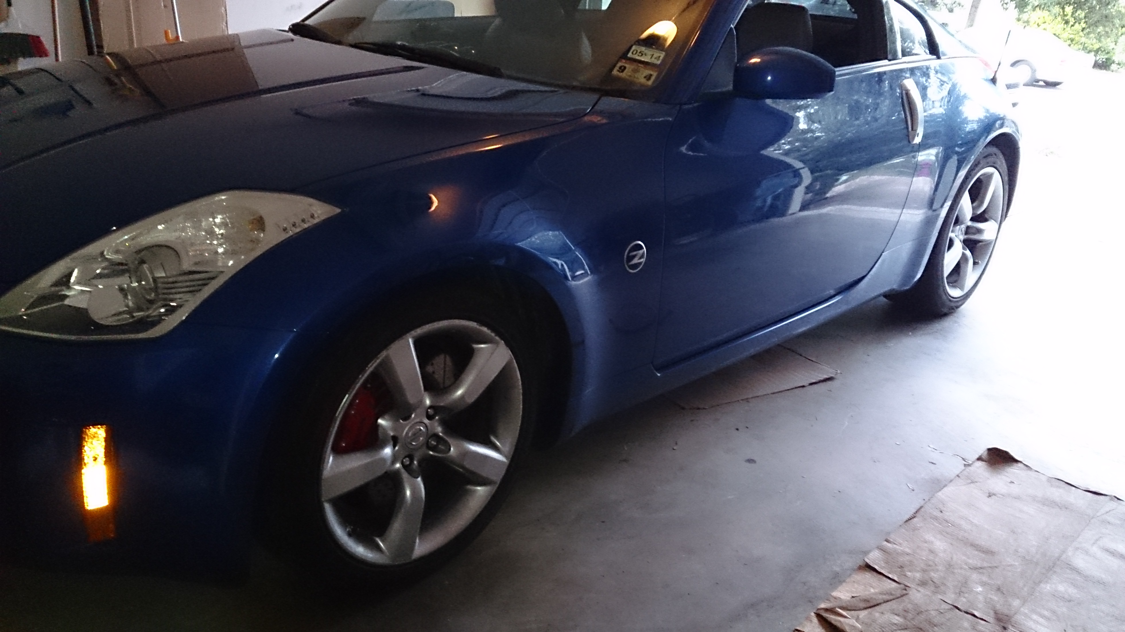

well it's about time
Attached Thumbnails Z1 Brake Upgrade vs. 14" Akebono (BREMBOS STAY OUT)-dsc_0020.jpg   Z1 Brake Upgrade vs. 14" Akebono (BREMBOS STAY OUT)-dsc_0021.jpg   Z1 Brake Upgrade vs. 14" Akebono (BREMBOS STAY OUT)-dsc_0022.jpg
