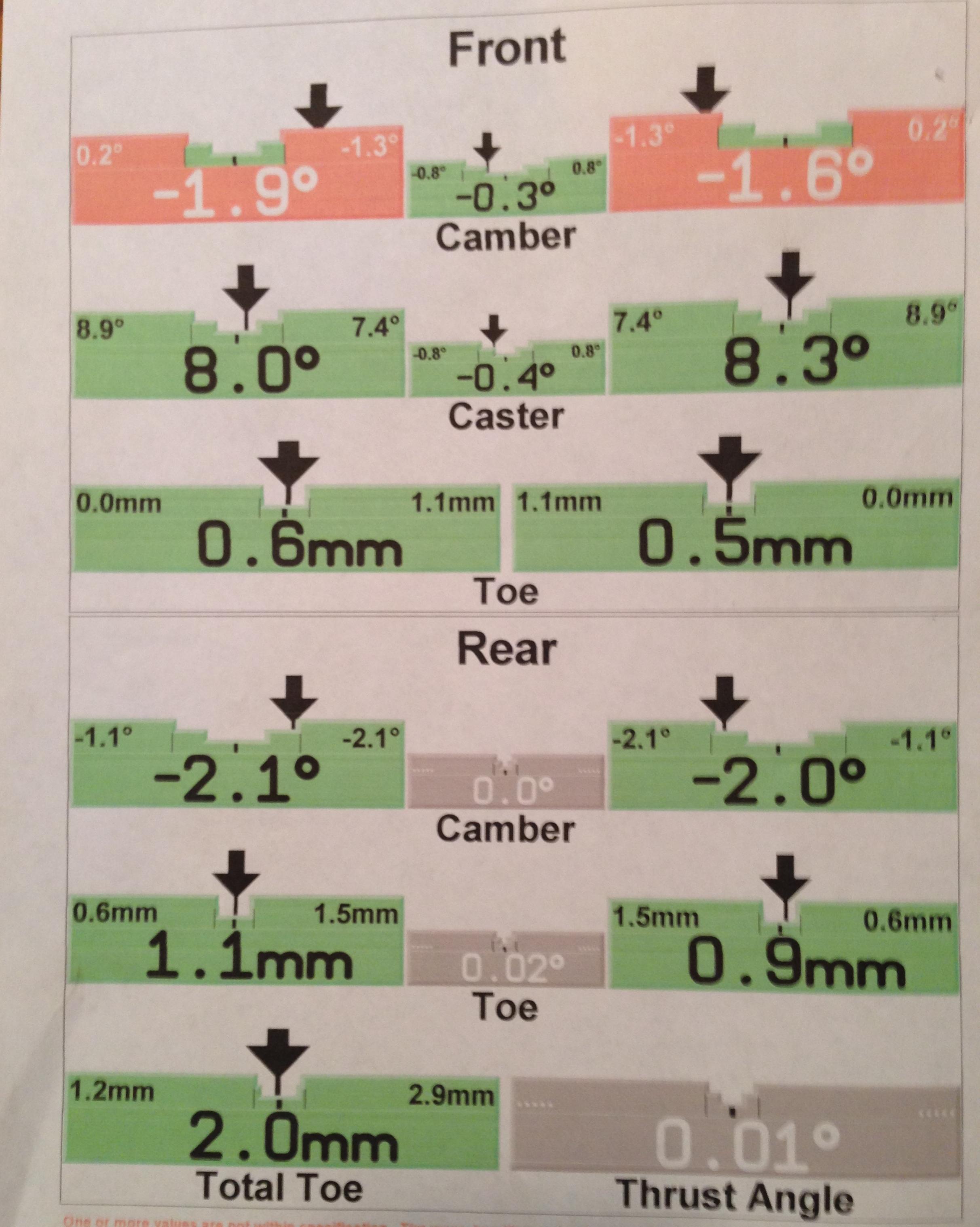

Just wanted to post up these numbers for people wondering how much lowering a Z on coilovers will mess up the alignment. Obviously it's different for every car but this is what happened with mine.
Before (stock height with 19" wheels 245/35 front 275/35 rear)
Front Camber: Left -1.4 Right -1.0
Front Toe: Left 0.05 Right 0.03
Rear Camber: Left -2.1 Right -1.8
Rear Toe: Left 0.10 Right 0.11
*All in degrees
After Drop but Before Alignment (1" drop front/rear with KW V1's)
First pic with red every where
After Drop after Alignment
Second pic with mostly green
To compare Toe from before the coilovers to after you will need to convert the degrees to mm. Just google it.
I did not buy any aftermarket alignment equipment. Front camber is unadjustable from the factory. The rear is barely adjustable.. He had to almost max it out to get me back in spec in the rear. The front is out of spec but I'm okay with it. Negative camber is good in the turns and a handful of autocross/track setups that I have seen for 350Z's had around -2 degrees camber in the front.
Link to my review of the KW V1's and some pictures.
https://my350z.com/forum/brakes-and-...r-results.html
