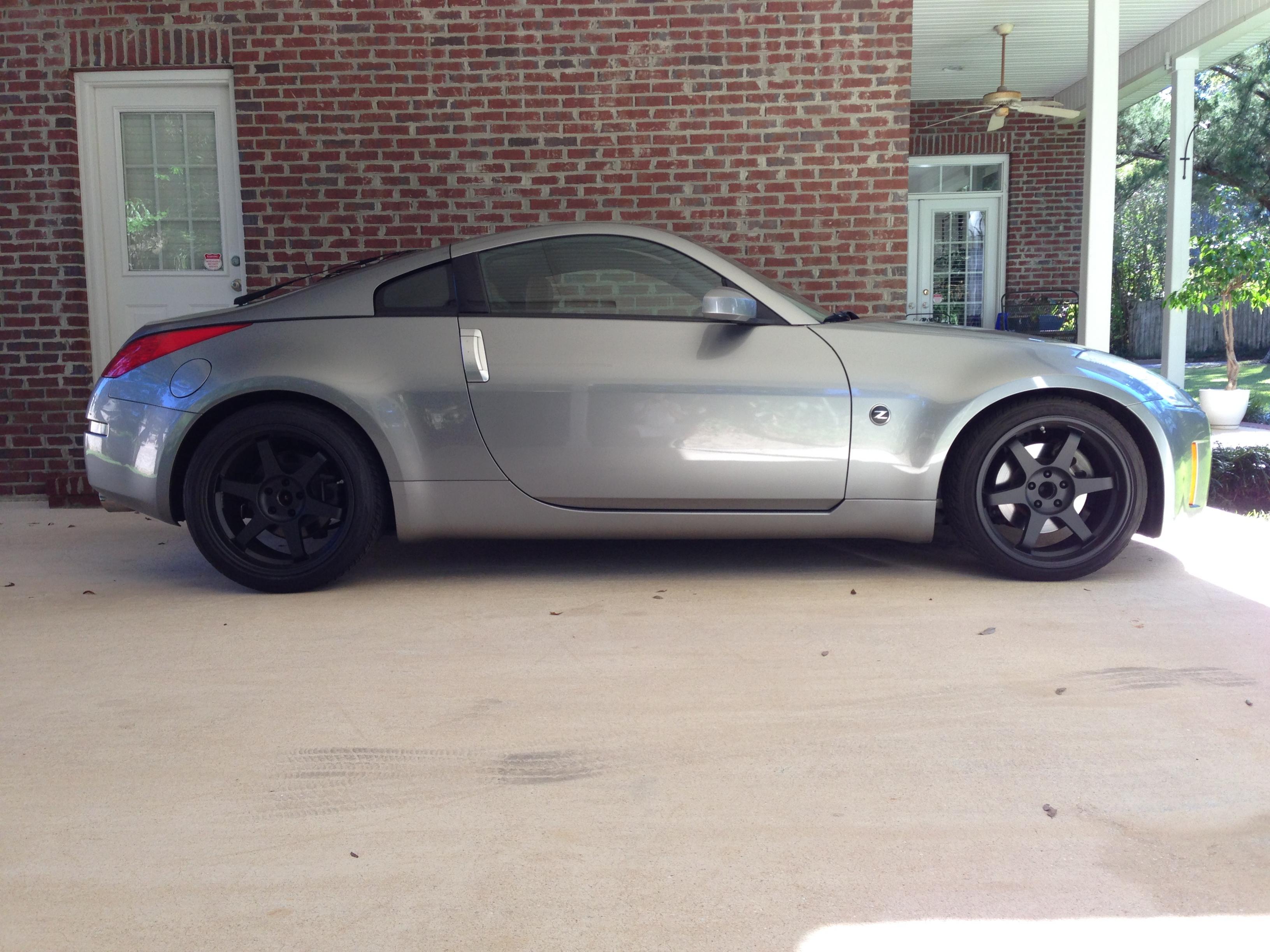

Install was pretty straight forward. Take out the old, replace with the new. No need for a spring compressor to install these coilovers. Might be helpful but we just unscrewed the nut with a ratchet and stood clear once it got close. Spring only jumped about three feet. Getting the rear springs out of the spring buckets was kind of hard but eventually they came out. We, in retrospect, stupidly left out the metal collar thing that was on the original shocks. We assumed they were only there for the big shock boot but that's not the case. They keep the damper in place. And last but not least, the rear spring perch has to be removed to adjust the height in the rear. It explicitly states this in the manual for separated shock/spring systems. Not that big of a deal however because it only takes 1 bolt to release the spring bucket and get the perch out.
Review:
The ride is excellent. I already had sway bars before the install but it is significantly stiffer and planted with the coilovers. They made a MUCH bigger difference than the sway bars did. Its far from harsh though. I was expecting it to be uncomfortably harsh and would not have been upset if it was but that is just not the case. The dampers soak up the bumps just as well as the stock suspension did, if not better. Body roll is basically non-existent as far as I'm concerned. Ride height is adjustable - the front goes incredibly low... I think you could almost sit the fender on the tire. The rear goes pretty low but not as low as the front. I have the rear perch set halfway between its lowest and highest setting. My drop ended up being 1" all the way around.

The first photo should be before and second photo should be after. If anyone wants more photos just let me know.
