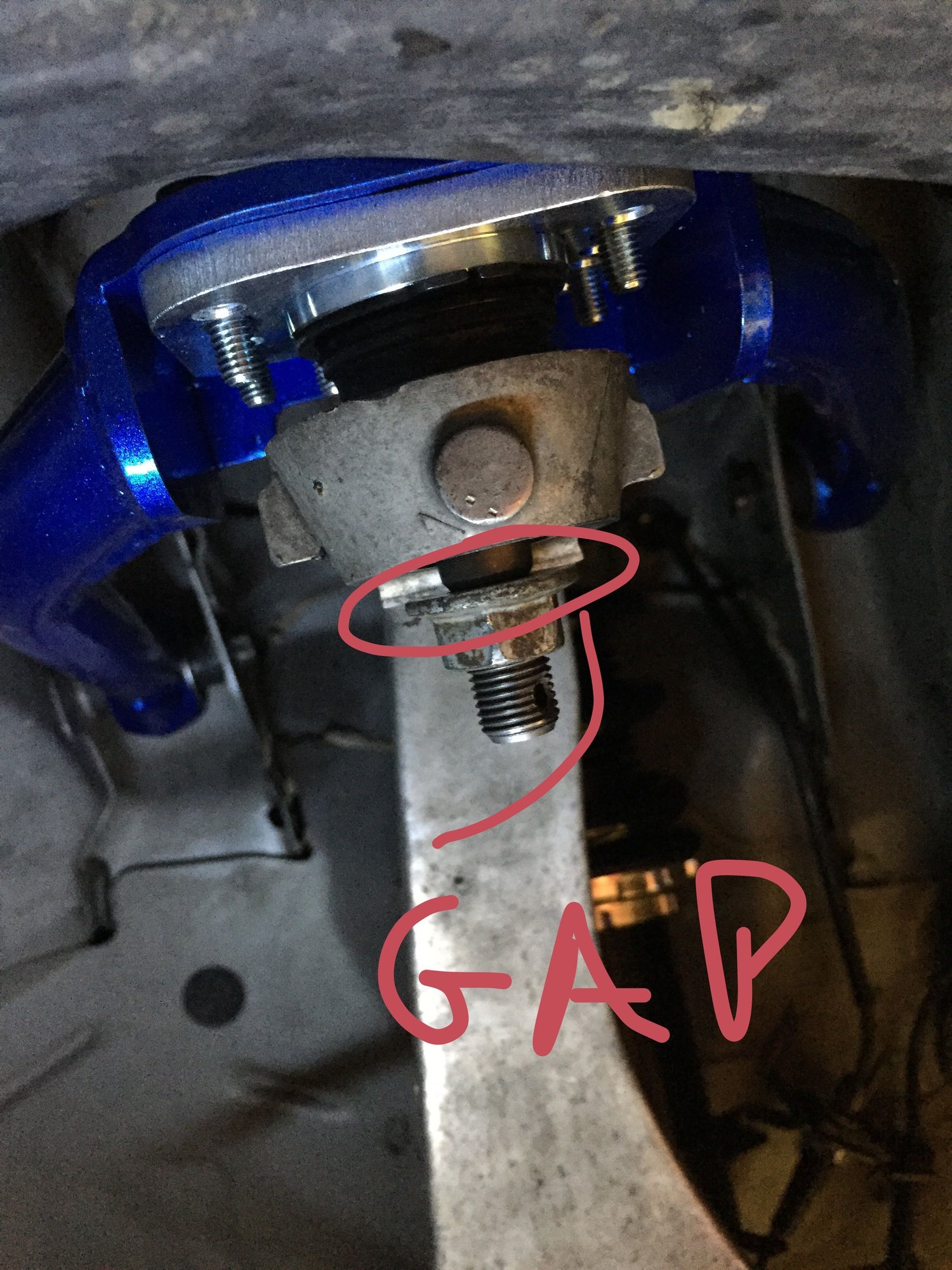

Hi everyone, I am back for help from the experts once again. This time I am in the process of installing Cusco upper control arms and have a question.
the ball joint on these upper control arms almost seems as if it is too long. When I insert it into the top of the upright it comes so far through that even with the nut fully threaded on it still has vertical play. This does not seem like it could possibly be correct and or safe. Am I missing something here?
Am I supposed to pull the bushings off of my stock arms and fit them onto these?
picture for reference

I think your missing the cone

Are you using the cone or no ?
Is the cone this part from the stock arm?
Was that meant to be swapped over?

Yes this the one, re-use it if the new arms didn't include one.

I see! Thank you for the clarification. All the documentation included with these things is in Japanese and they didn't show that in any of the pictures so I wasn't sure.
