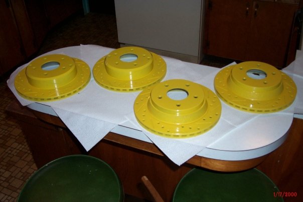

Originally Posted by JCat
Looks like a good way to gum up the brake pads the first few times the brakes get hot. That yellow paint or ceramic coating will wear away and STILL reveal a shiny silver finish underneath. Before that, you'll notice a severe lack of braking ability as the paint or coating wears off.
How is that a good idea?

At first GLANCE, thought that was a pic of sunnyside up eggs.
A little attention deficit on my part.
Why do I feel the person that did that either over uses the word "mint" and or "bruh", or often says "hold my beer"..?

Come on... yellow? black? silver? All very lame since everyone knows if you painting rotors you want the most stop-y color which is Brembo gold or red
