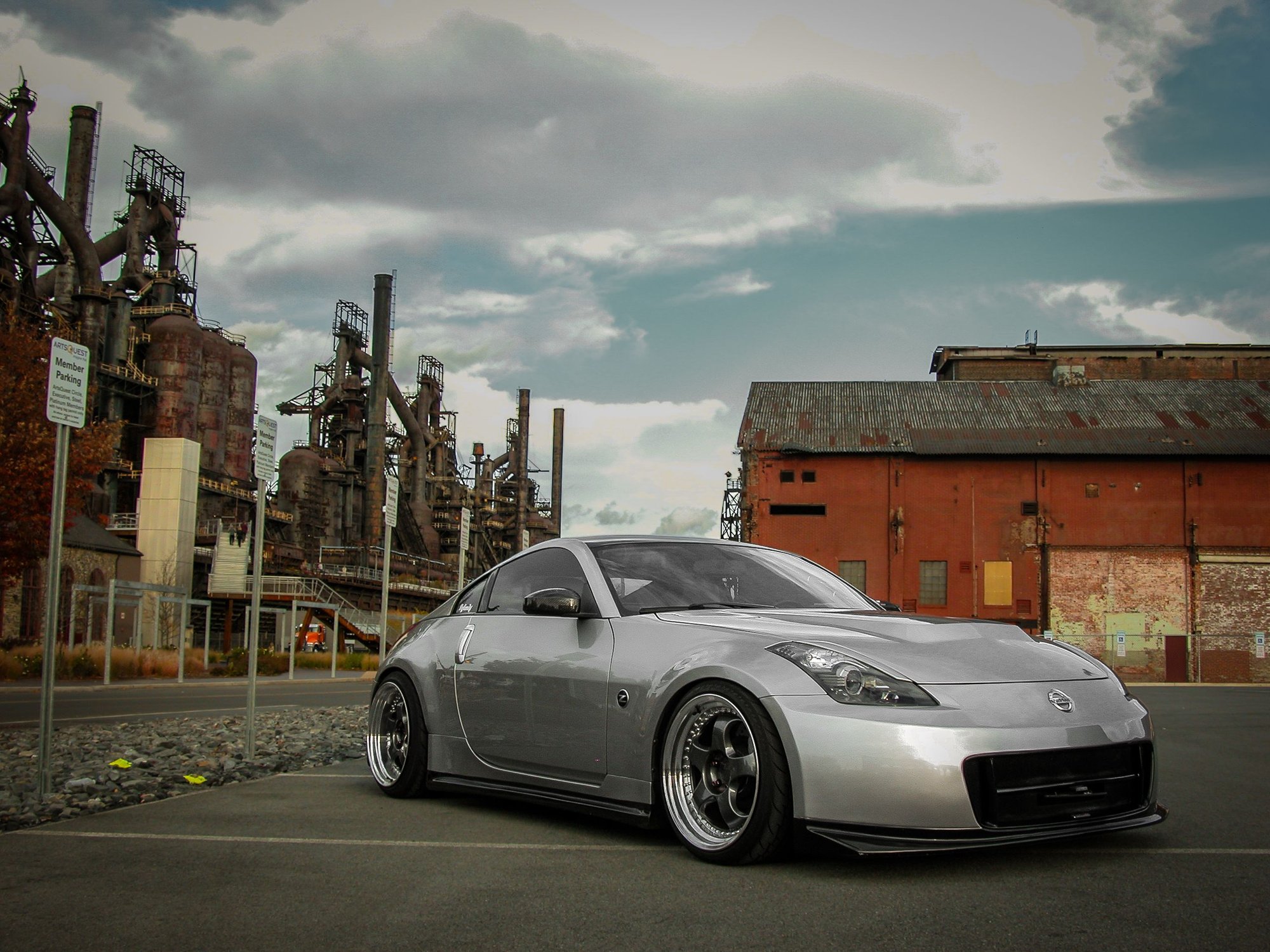

2.5" drop
19" wheels
35 series tires

That looks amazing! You get around okay?
Originally Posted by jdmfetish
2.5" drop
19" wheels
35 series tires
Old May 2, 2017 | 08:25 AM

Scrapes going in and out of my driveway ( its inclined ) , but only on the spoilers , and can only be seen on the bottom of the spoilers not the top or sides. If you want to lower it this much and stay in factory alignment spec, FUCA, RCA, RTA, my coils are true not OEM so RTL as well. Also you will need new adjustable sway bar end links front and rear, or you will go thru OEM end links constantly.
