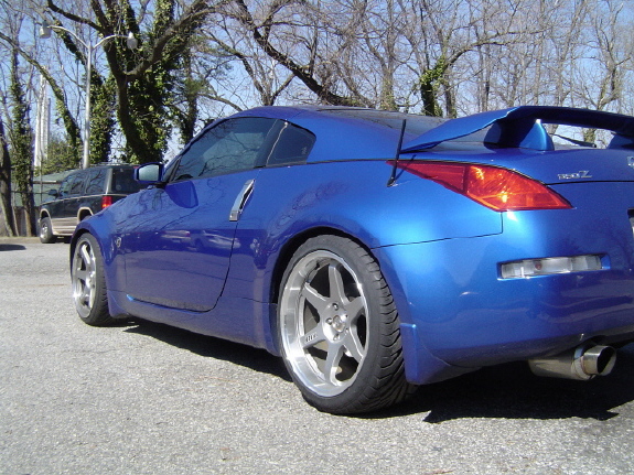

Just got my Espelir springs from Jeff@Evolution yesterday! They look and ride fantastic IMO.
The drop is 1.5", and I absolutely love it so far.
EDIT*
Im sorry about these pics, they seem really choppy I need to find a site to host bigger pics, because when I size these down they become distorted. I'll try and get some better sized pics soon!

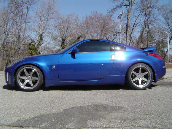

side

Nice drop, I also got the Espelir springs and love them.

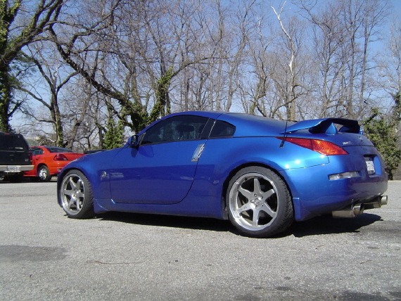

another shot

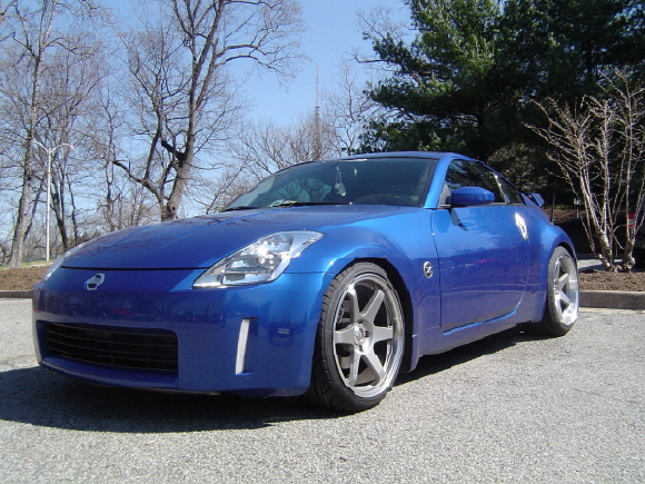

last one for now...damn these pics look awful sized down, I'll get some much better pics at the Evolution meet tomorrow, I PROMISE!

looks good but the pics are killing it...send me the full size good quality pics to xssive337@aol.com and i will resize them and host them for you if you would like. I'd like to see how it looks without distorted pics hehehe.

Shietty pics, awesome car!!!! Definitely have someone take some better pics.

Nice wheels! What are their specs/size?

Front = 19x9.5 +22
Rear = 19x10.5 + 22

And the tires make and sizes? Did you roll the fenders?
I'm waiting for my TE37's in the same sizes except that the fronts are 19x8.5 I'm seriously considering going with 285/30 on the rears but don't know if they will rub even if I bend the fenders.

Your have done a fantastic job on your Z. How did you remove the amber reflector from the headlight housing? Did you have take it apart - if so do you have any fogging or leaking now?

Javi - Nope, did not have to roll the fenders. With the setup I'm running, no fender rolling or extra body work has been needed
Im running Toyo T1-S 245/35/19 up front, 275/35/19 rear, wheel sizes/specs listed above. I cannot say if you run different sizes you wont have issues with rubbing or anything, but I do know for this setup you wont have a problem.
All bs-
Thanks for the compliments
I had my headlights cleared by a member on this forum " w1ngman " - just do a search for his name, you'll see where he has posted his info and other shots of my Z. He took the headlight housings out, baked them, took them apart, took out the amber strip, then reversed the process. They look fantastic IMO. You can always PM him too and talk to him about it, he's a super nice guy, he'll answer anything about the whole process.
