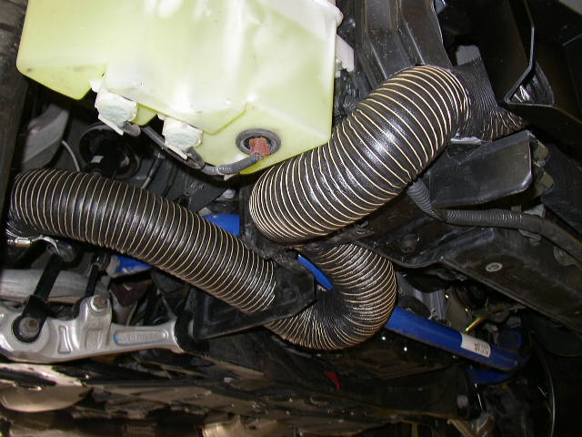

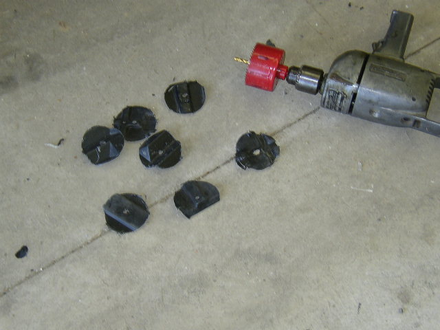

With a friends help, a lift, and a 3 1/8" hole saw, I finally got my N-Tech brake duct kit on!!!!!!
I took about 50 pix, and will post when I get them organized.
Like Jason, I still have a slight "crunching" sound when I near full steering lock.......but I"m pretty sure all I have to do is shorten the fiberglass ducts about 1 1/2".
mcclaskz, thanks for your pix.....they helped! Are you running the 14" Stoptechs? My friend has them, and his kit has no reduced steering lock. We guess that the brake line banjo bolt being 1/2" further "out", alleviates the interference problem Jason and I are having with our 13" kits.

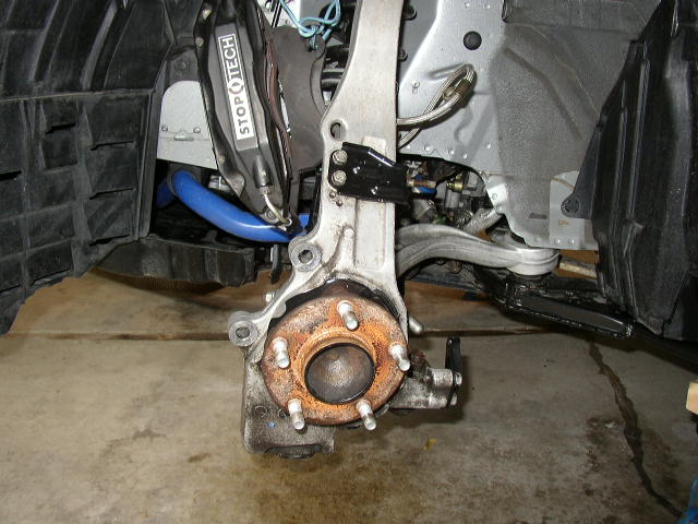

In no particular order, here are some of the pix I took.
Weight Reduction:
Attached Thumbnails Front Brake ducts installed!-brake-duct-install-5-29-45.jpg

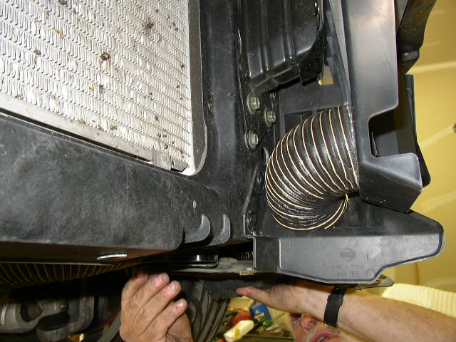

Posts: 1,965
From: Chicago Burbs
Don't need no stinking backing plate!
Attached Thumbnails Front Brake ducts installed!-brake-duct-install-5-13-8.jpg

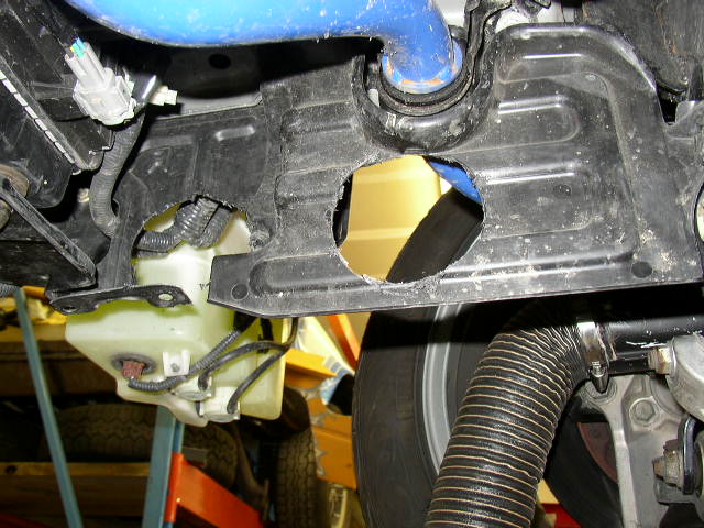

Posts: 1,965
From: Chicago Burbs
A right front hole:
Attached Thumbnails Front Brake ducts installed!-brake-duct-install-5-29-8.jpg

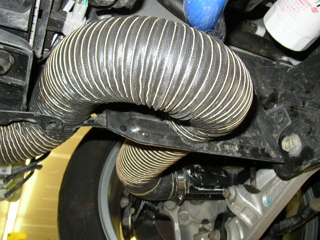

Posts: 1,965
From: Chicago Burbs
More RF holes:
Attached Thumbnails Front Brake ducts installed!-brake-duct-install-5-29-16.jpg

Posts: 1,965

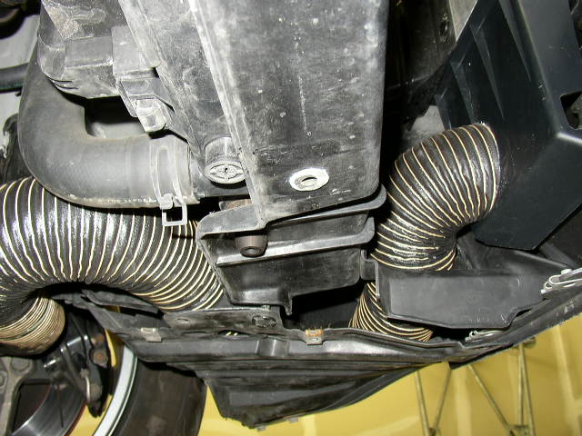

From: Chicago Burbs
RF with hose:
Attached Thumbnails Front Brake ducts installed!-brake-duct-install-5-29-19.jpg

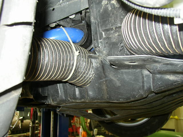

Posts: 1,965
From: Chicago Burbs
Another RF with hose:
Attached Thumbnails Front Brake ducts installed!-brake-duct-install-5-29-22-ps-hose-on.jpg

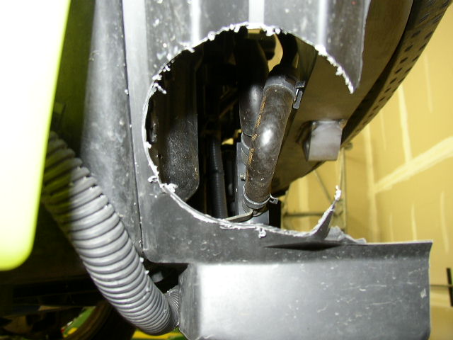

Posts: 1,965

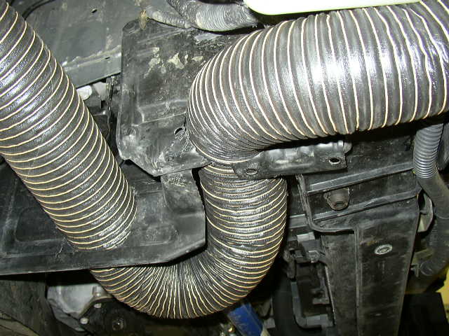

From: Chicago Burbs
RF with pan on:
Attached Thumbnails Front Brake ducts installed!-brake-duct-install-5-29-26.jpg

From: Chicago Burbs
Another RF:
Attached Thumbnails Front Brake ducts installed!-brake-duct-install-5-29-21.jpg
